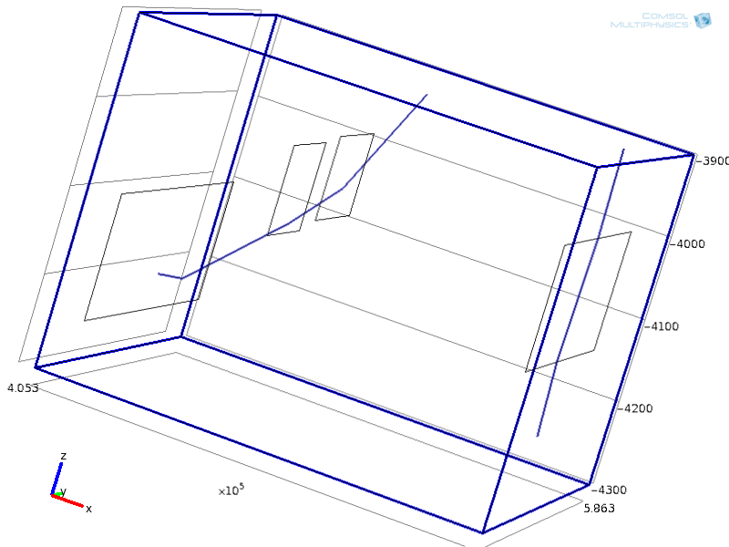

I have four 2D Bézier polygons (rectangles) and two 3D Bézier polygons (tubes) integrated within the 3D (extruded) block. I assigned Darcy's Law (Darcy's Law Material Model and Storage Material Model, (maybe) fracture flow and mass flux as well).

yet, I did define BC for all geometries i.e. Storage Material Model for each of them, but to no avail.
you talked about 'consistent BC', how to make sure a consistency? I mean, anywhere to check that?
