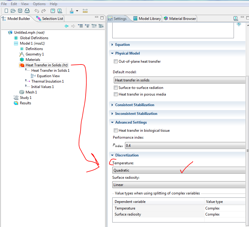

Posted: 1 decade ago 7 nov. 2011, 21:10 UTC+1
could it be this one ? (I'm in v4.2a)
Hi could it be this one ? (I'm in v4.2a) -- Good luck Ivar
