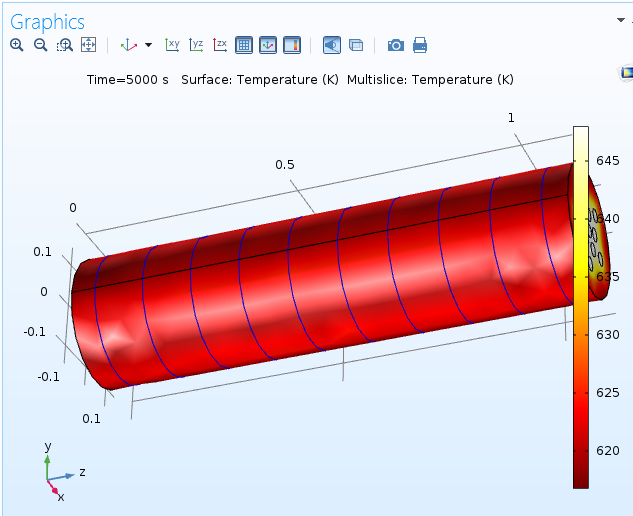

Hello, I was trying to formulate temperature distribution in a thick pipe due to the heat transfer from flowing hot fluid. After calculations, I tried to represent the distribution in the form of SLICE plot. I clicked on RESULTS<SLICE, and then after setting it up, clicked on PLOT. I got thick SLICES in my screen as in uploaded picture. I can only see cross section at x=0.
What should I do? Please Help....

It seems as if the plot group to which you added the slice plot already contains a surface plot. I suggest that you disable or delete the surface plot.
