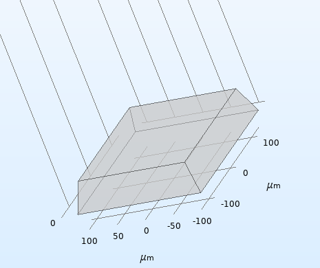

I am currently simulating the optics of an implantable LED-lens system. Here, the LED has the shape of a hexahedron (Picture of LED attached). Five faces of the LED serve as ray sources. My plan is to define a set of points on each face and have them emit rays in a spherical fashion, with the axis of the rays perpendicular to that particular face. In order to do this, I plan to use the "Release from Data File" node of the Ray Optics module. As the axis vector for each face is different, I created five different data files, each containing a set of points on that particular face. Then I imported them to five different "Release from Data File" nodes. On running the study (I am using "Bidirectionally Coupled Ray Tracing", as I also need to study ray heating effects), I get the following error:
