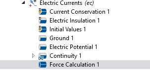

Or instead to calculate EM force on the body, you can add electrical current node and add "force calculation node" it will automatically give you the exact electromagnetic force (Fx,Fy, Fz) for the selected domain.!
Is it a feature only on 5.4? How to add it? Cause I can't find just a node in my 5.3a. I also check the reference manual for 5.4 but can't find anything about 'Force Calculation'.

My guess is that you are not seeing the "Force Calculation" feature because of the modules that are included, and not included, on your license. Does your license include the AC/DC Module or the MEMS Module? That feature is available in those two products. You can check what modules are included on your license by going to File > Licensed and Used Products.
Wouldn't this give the integrated force over the domain, rather than the local force density, which is what is needed for coupling with phase field fluid dynamics?
