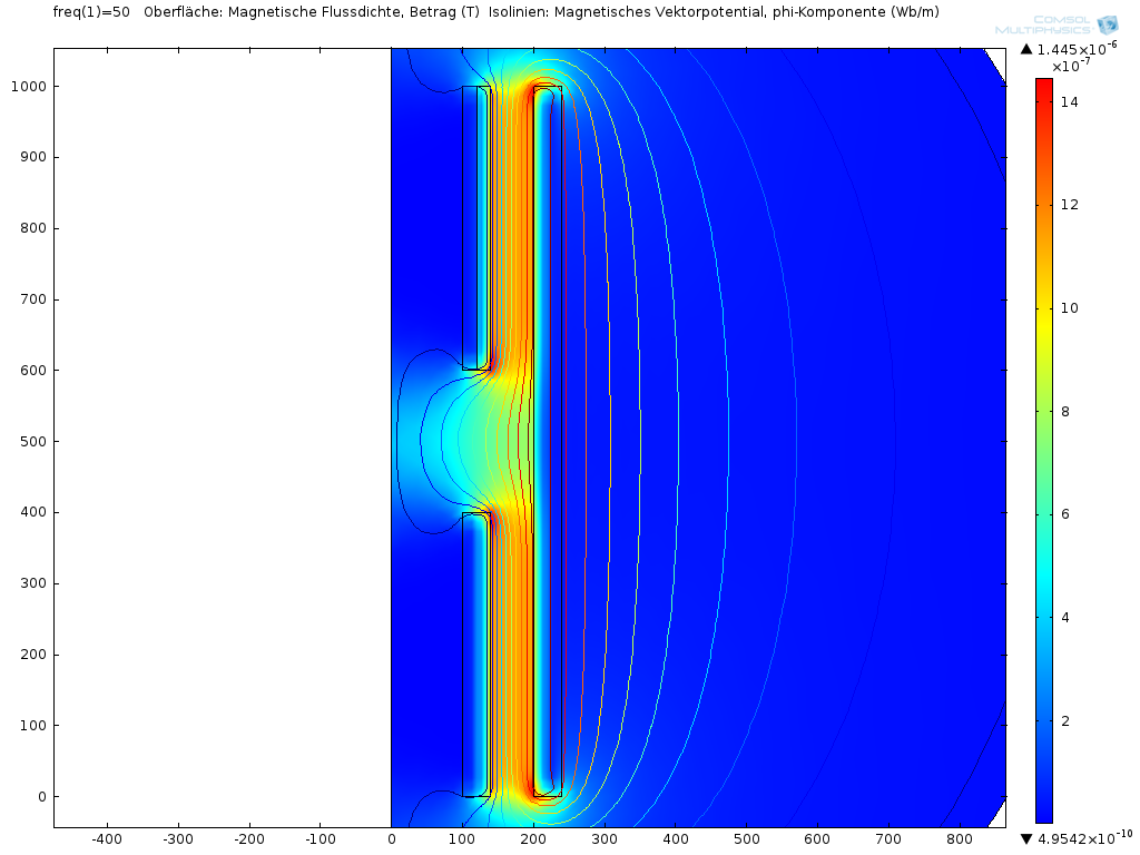

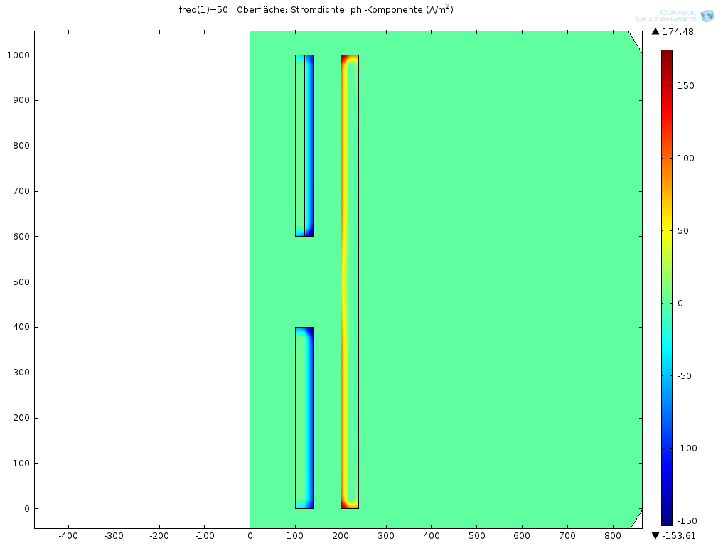

in MEF you can check, if Transition Boundary Condition is working for you.
For frequency domain I have modified your example (MEF is not for transient).
Ralf
