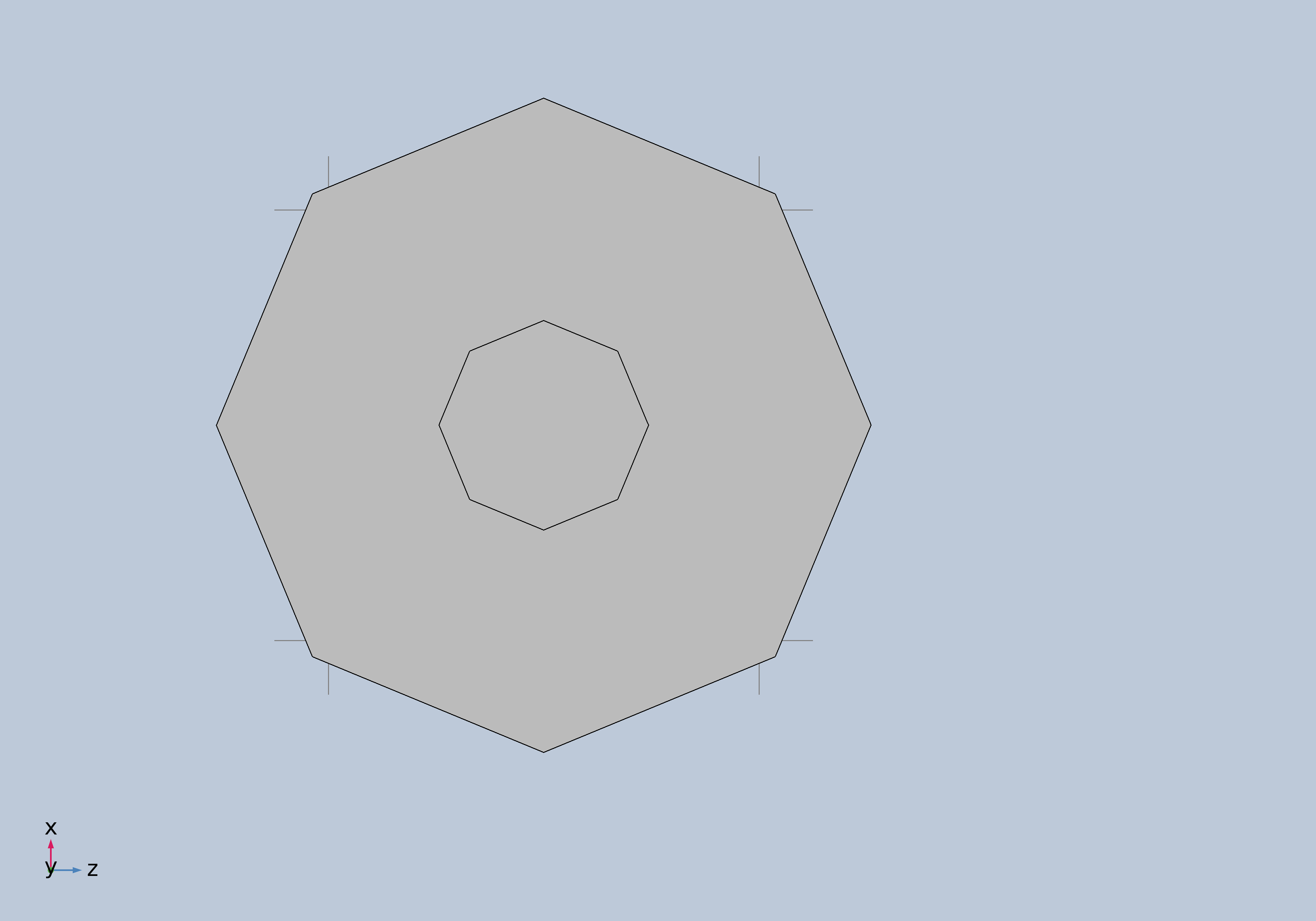

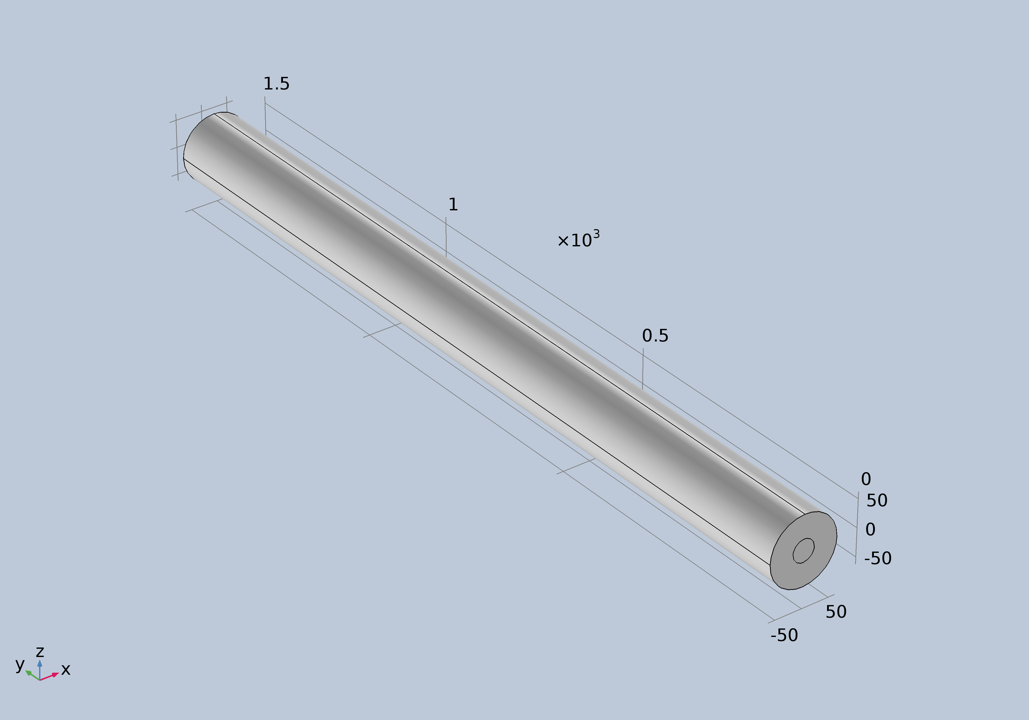

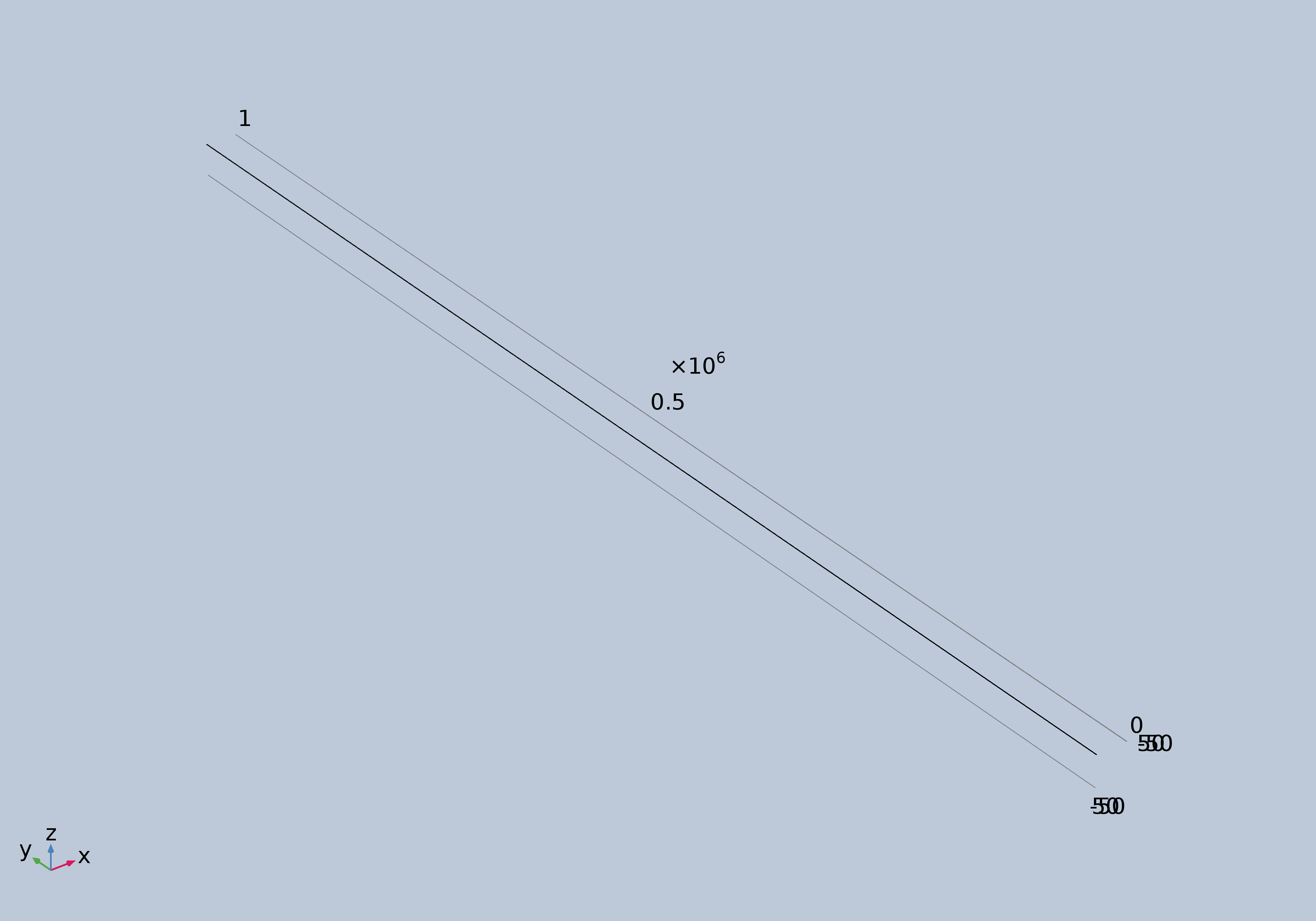

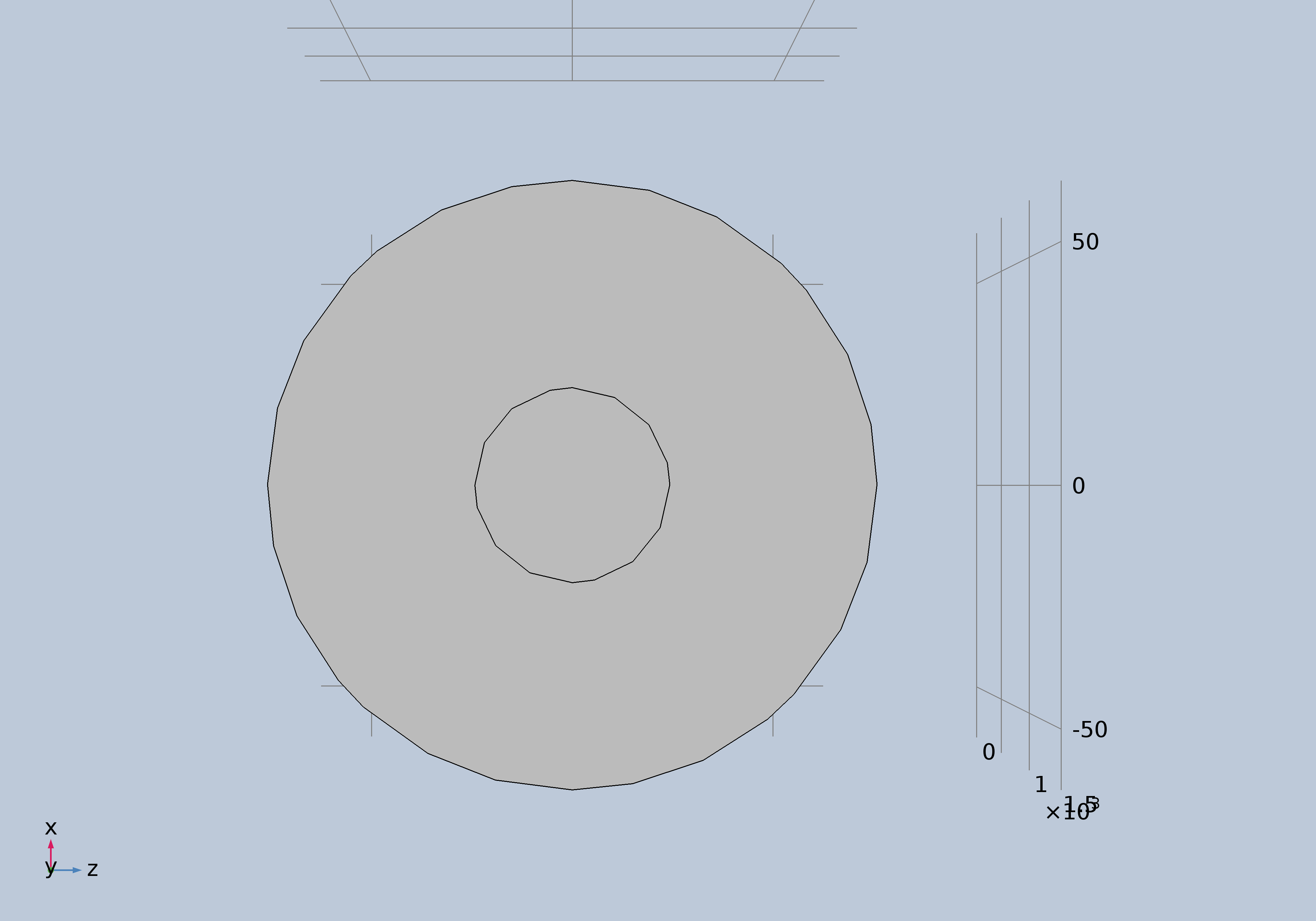

                                                    This is a rendering effect due to the high aspect ratio, and it has been discussed before in this Discussion Forum, see e.g. https://www.comsol.com/forum/thread/77211/object-shape-changing-due-to-high-aspect-ratio?last=2015-05-19T18:02:19Z .
The cross section of your geometric object is still a circle even if it does not look that way on screen. This will become obvious when you mesh one of the end surfaces of your fiber.
