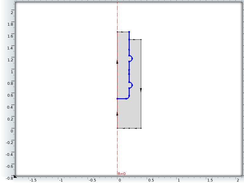

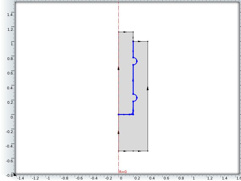

I seemed to have resolved the issue I originally asked you about.
If you look at the two attached images, one shows a contact pair along the interface only, and the other shows a contact pair that extends above when the "pin" exits out of the surrounding material. I'm not sure why my assembly step in 4.2 created the latter type of contact pair, but that seems to be the problem. I say that because when I used the geometry and contact pair as created in Comsol 3.5a (first image attached), the model ran OK in 4.2 -- although only with a fully coupled solver, not the segregated solver. (This 4.2 solution agreed with what I had found in Comsol 3.5a previously.)
