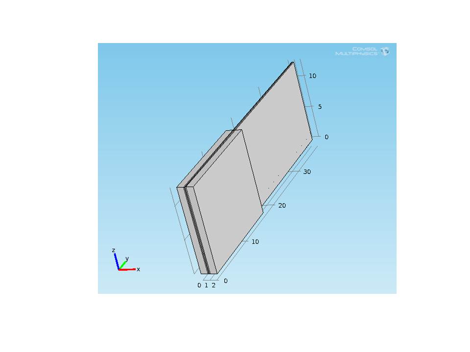

Why in my model I insist on mapped meshing is the following reason - one of my consisiting elements is a 100µm thick tape that covers a microscope cover slip (76.2x25.4x0.13mm). I reduced the calculation by introducing two axes of symetry and yet teh following is the issue (I wont say problem cause it will get done)
finest triangular mesh that does not meet basic convergence criteria (3 elements across smallest gap) - 780 000 elements
a mapped mesh with 7 elements across each of the thin layers -80 000 elements
Since this is my thesis work and research in progress, I'm reluctant to upload the file, but here is an image of the device just to have an idea. If you are interested in teh model and it's problems from a software troubleshouting point of view, I can send it to you.
Again, thank you for your help, the feedback is greatly appreciated
