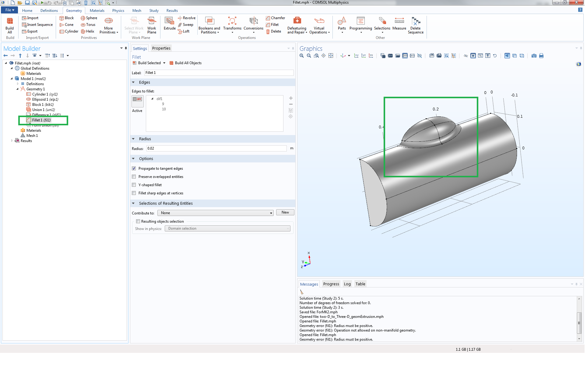

Update on this thread: Nowadays COMSOL does include a direct 3D filleting capability in the Design Module (See www.comsol.com/design-module). A screenshot of you file with the added fillet is attached.
Update on this thread: Nowadays COMSOL does include a direct 3D filleting capability in the Design Module (See www.comsol.com/design-module). A screenshot of you file with the added fillet is attached. Best, Jeff
