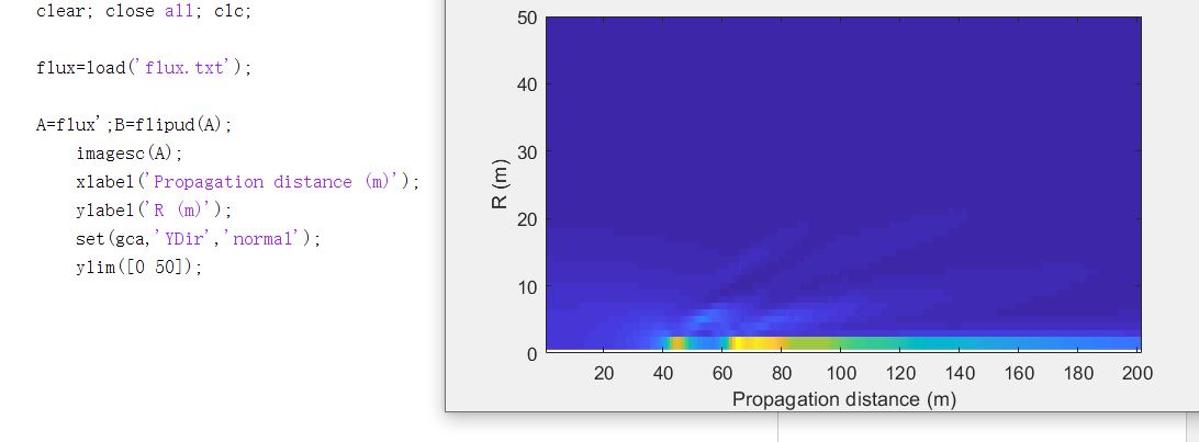

Dear Jeff, I have used the Interpolation Functions to import my calcuated data,which is shown is the figure 'res.JPG'. However, it was a far cry from what I wanted. The initial field that I want to express is shown in figure 'matlab.JPG', which is handled by matlab. I don't know how to express this result in comsol. Especially if my initial result is near the boundary, how do I specify the its location. I searched the case database for a long time but could not find a similar case. I hope you can directly give me some links to similar cases. Thank you. Zeng
