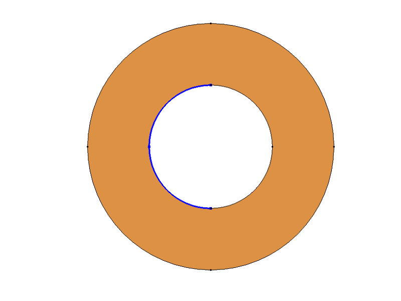

  1. I would like to solve time-dependent heat transfer problem in 2d
  2. On some boundaries there (see figure) are prescribed time-dependent incoming heat fluxes, in the form of goniometric functions: , where and are parameters I would like to vary later.
  3. In the module heat transfer in solids, I took "heat flux", out of three possibilities there, I don't know which I should chose, and how to implement my heat flux boundary conditions, say for is 1000 W/m and 20 Hz.

if I understand properly this should be quite simple. The expression in the q0 field would look like: q0*cos(omega*t)^2
Define q0 and omega as global parameters or directly insert the values. Make sure that the time stepping properly resolves the function.

Thanks Edgar, it works now ... :)
Cheers,
D.
PS: the time step was inappropriate
