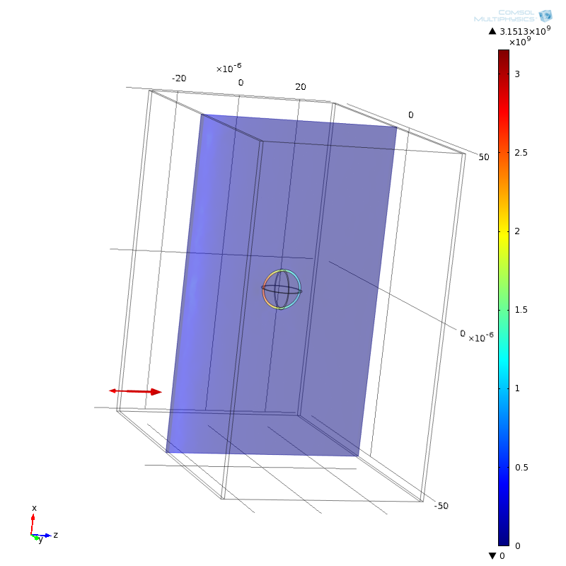

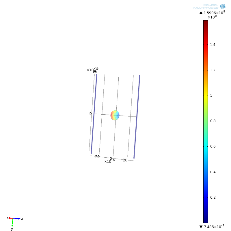

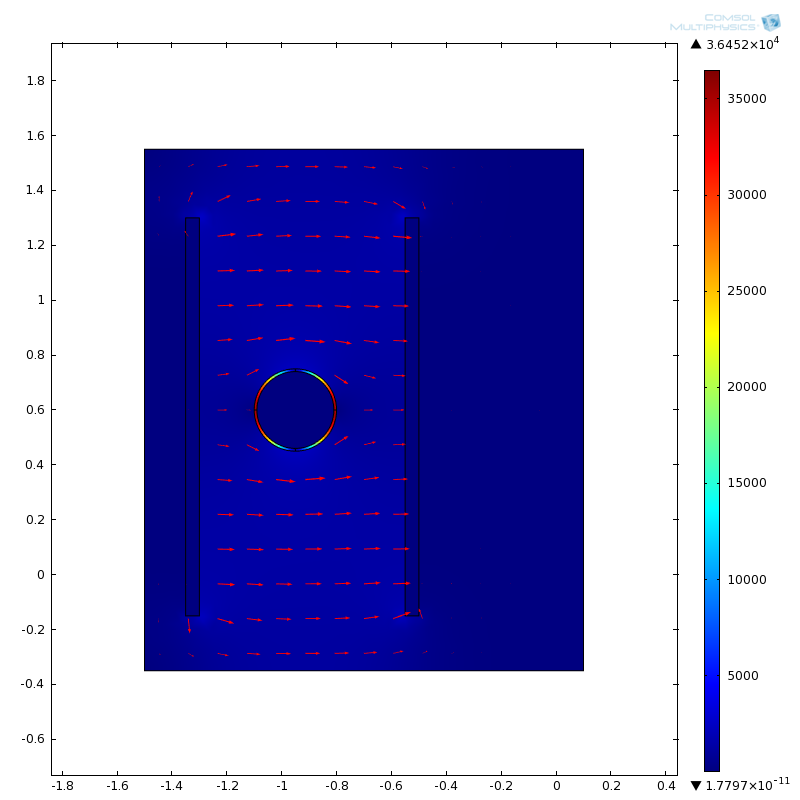

                                                    Hi John,
Thanks for your quick response; your comment has helped me to represent the part I needed.
However, the result is not that I expected, the electric field asymmetrical (attached figure) , when it should be symmetrical about the center. In addition, the electric current arrows are out of the slice, have you had the same problem?. There is someone who has previously resolved?
Thanks in advance,
Michael.
PD: I attached two images, one with the slice and other with the expected slice.
