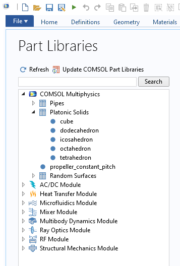

Hi Skandan,
In the latest release, COMSOL Multiphysics 5.5, the Part Libraries include an octahedron as well as all other Platonic solids.
See also https://www.comsol.com/blogs/how-to-use-the-platonic-solids-as-geometry-parts-in-comsol/.
Magnus Ringh, COMSOL
Hi Skandan, In the latest release, COMSOL Multiphysics 5.5, the Part Libraries include an octahedron as well as all other Platonic solids. See also . Best regards, Magnus Ringh, COMSOL
