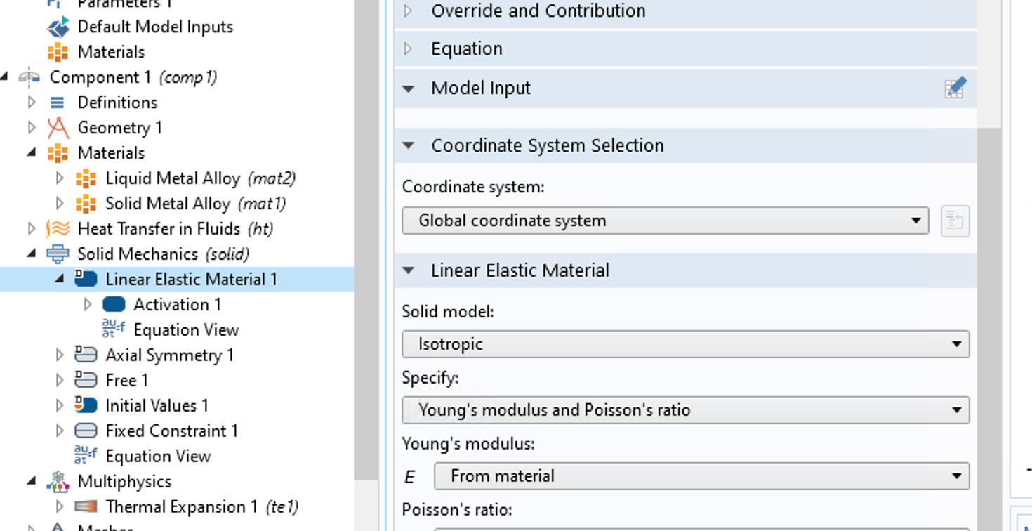

For some reason I can not see the strain reference temperature option. Do I have to activate that option somewhere?
I have attached a screenshot. I assume it should be in the Model Input Section?
Kind regards and thank you in advance.
Thank you very much for your answer. For some reason I can not see the strain reference temperature option. Do I have to activate that option somewhere? I have attached a screenshot. I assume it should be in the Model Input Section? Kind regards and thank you in advance.

Hi Andreas,
What Mats is referring to is the "Volume reference temperature" input in the Thermal Expansion node; that is the temperature at which there is no thermal strain.
Henrik
Henrik Sönnerlind
COMSOL
Hi Andreas, What Mats is referring to is the "Volume reference temperature" input in the Thermal Expansion node; that is the temperature at which there is no thermal strain. Regards, Henrik
