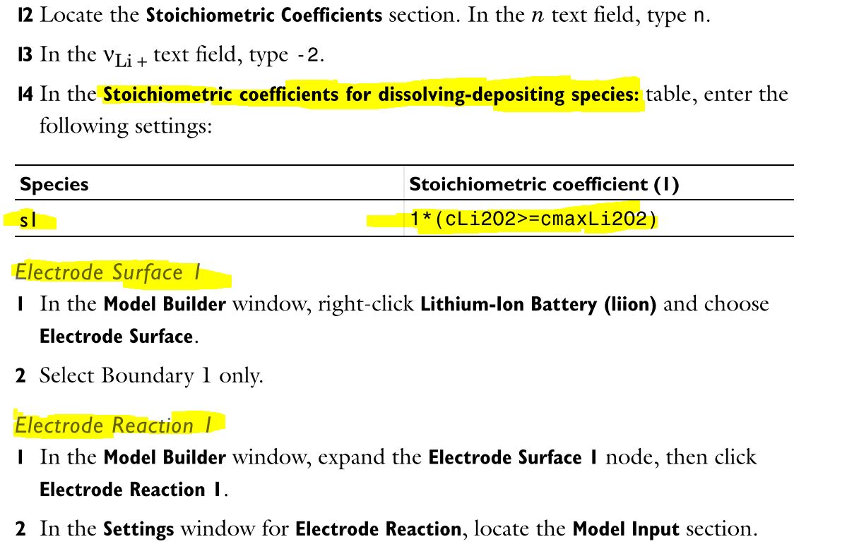

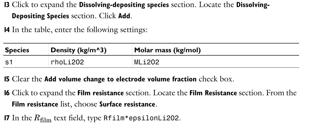

I was trying to repeat the 1d lithium-air battery simulation tutorial(COMSOL 5.3a) available on COMSOL website. Since I have electrochemistry module only in COMSOL 5.0 version, I was trying to simulate the same in 5.0. But, I can not able to see some sections like "Dissolving-depositing species", "Stoichiometric coefficients for dissolving-depositing species" and "Electrode Surface" in 5.0. Can you please help me to incorporate these things in the COMSOL 5.0.
I have attached files for more clarification, please have a look.
