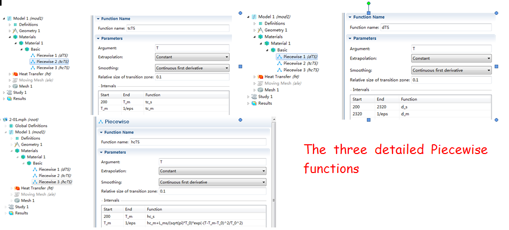

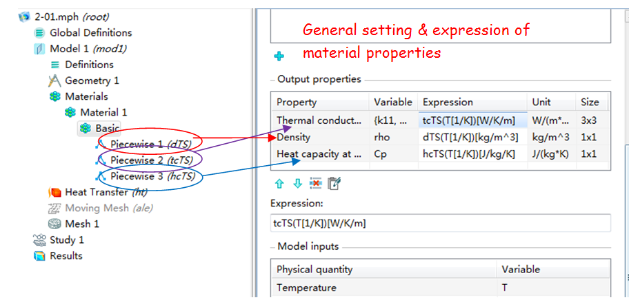

According to all what I know, I definite three "Piecewise function"s just under the Model 1 --> Materials --> Material 1 --> Basic branch, just shown in Fig. 1.

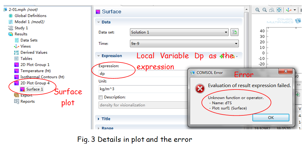

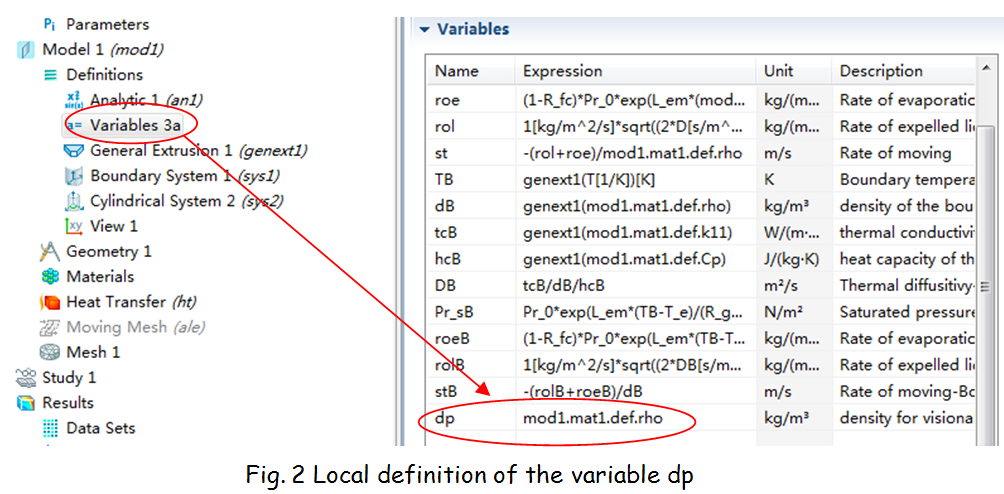

In order to check its validity, I defined a local variable with the name of “dp” (see Fig. 2) to visualize it. While after I solve the model, I come to the Result --> 2D plot group --> surface, and use the variable “dp” to present the expression to plot the density distribution in the domain, which should be different due to the temperature difference. The
“Unknown function or operator.
-Name : dTS
-Plot: surf1(Surface)”
error occurs. I am quite puzzle about this. Please give me some guidance. Thanks.
