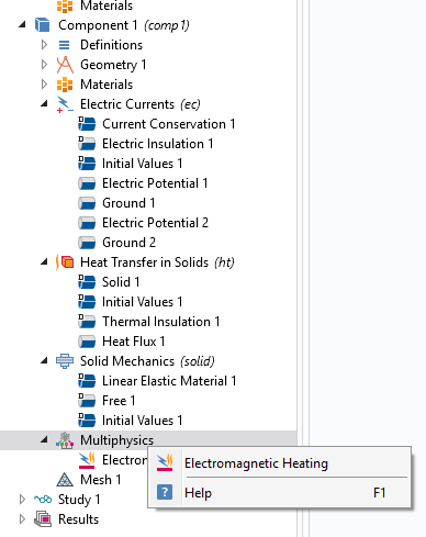

why the Multiphysics only have Electromagnetic heating? please give me a hand.
don't have other choices. only have the ecletromagnetic heating. my version is 5.5.

Which options are available to you in the "Multiphysics" branch of the model tree depends on 1/ the physics interfaces you have in your model, 2/ the products that are included on your license (You can check on that through File > Licensed and Used Products), and 3/ the version of the software you are using.
Hello, Which options are available to you in the "Multiphysics" branch of the model tree depends on 1/ the physics interfaces you have in your model, 2/ the products that are included on your license (You can check on that through File > Licensed and Used Products), and 3/ the version of the software you are using. Best,
