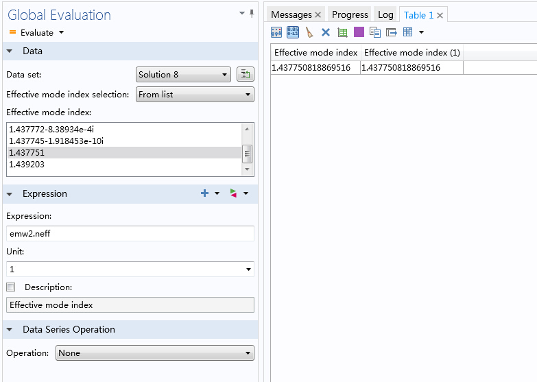

                                                    Thanks for your immediate reply. The thing is I have setup the PML layer and get the imaginary part for most of the effective indexes. But the problem is, for the optimal effective index with minimum value of imaginary part, I can not see the exact value of imaginary part. I guess it may be a matter of the value is too small, e.g. <E-12i, so it is not displayed. The attach file is a screenshot of the effective index I got.

                                                    This is because the Imag(Neff) is too small. Loss is negligible.
You can see the full precision at comsol UI. On the bottom right (the table..), you generate your Neff and click the full precision.
Or if you have comsol matlab, you can see the full precision also.

                                                    I have tried evaluate neff in the table with full precious, but it just display the full precious of the real part, for the imaginary part, it is still not viable.  See the attache file for the detail.

                                                    get the imaginary part of neff.
imag(emw.neff)
i prefer to use comsol matlab, where you can extract the data directly.
imag(emw.neff)
