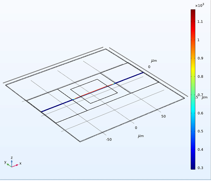

I have a relatively high aspect ratio device and am trying to plot the cross sectional area through the center, however the size difference is making getting any relevant images difficult. So my question is, is it possible to zoom out along only one axis (x-axis in attached image) to get better images?

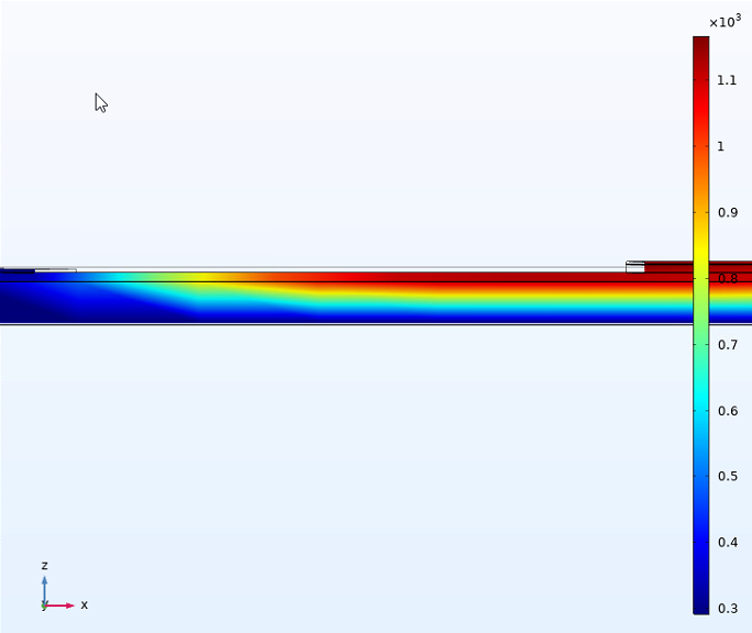

I've just found it, anyone else looking it's under Geometry -> transforms -> scale and turn scale factor to anisotropic.

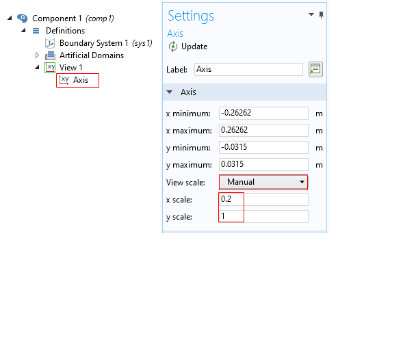

John,
You can use axis scaling to zoom out along the desired axis, as shown in the attached image.
Sergei
John, You can use axis scaling to zoom out along the desired axis, as shown in the attached image. Regards, Sergei
