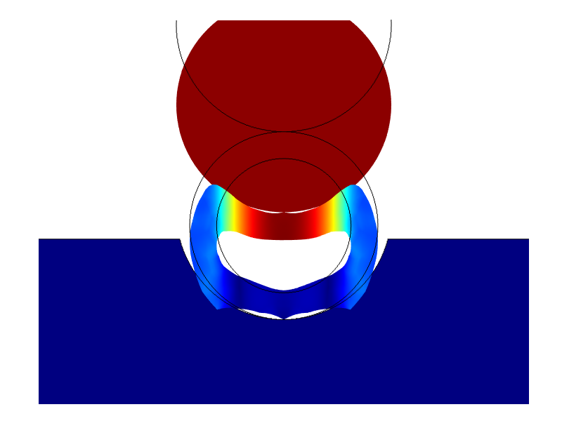

I am trying to model a 2D system similar to hyperelastic_seal. Unfortunatelly I get very often an error, especially when I want to make the mesh finer. If the mesh is coarse I got unsatisfactory results as two bodies are overlaping although there is a contact boundary. What should I change in the model. I attach both model file and a picture with plot of the any (but not ok) result. I got also similar error if I want compress the ring more than certain limit (both in case of predefined displacement or body load on the top body). What is the reason and solution/workaround?
