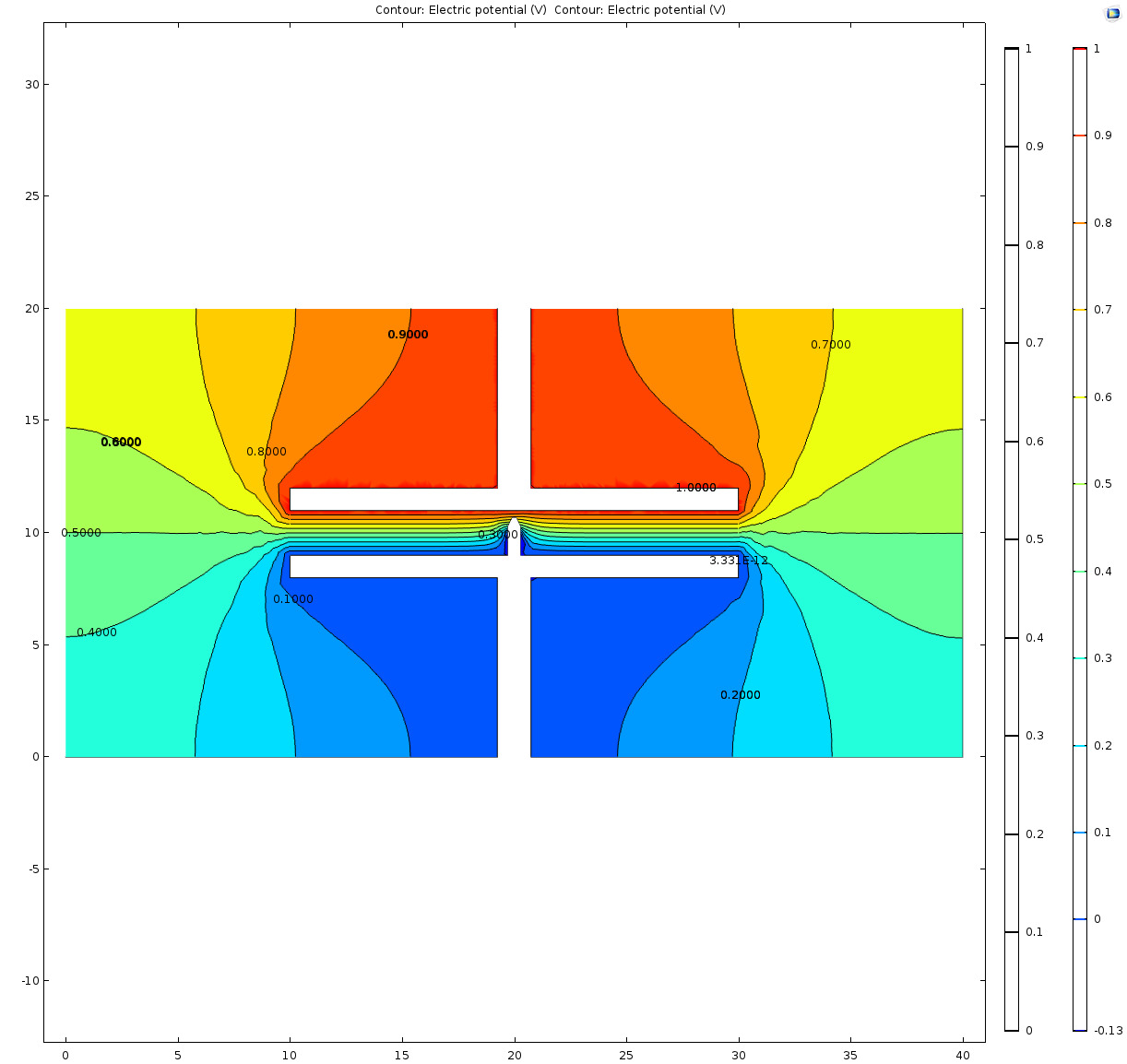

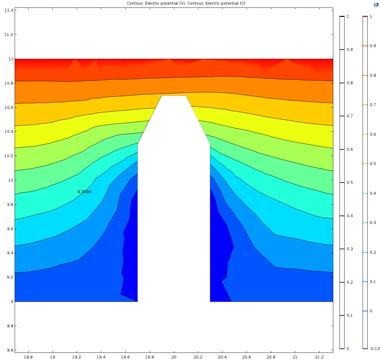

Yes, that sure doesn't look right.
1. Take a close look at your boundary conditions, especially on the needle!
2. You didn't show the mesh. If it is fairly coarse, and depending on the smoothing used in the plot, that could also be a problem. So if your boundary conditions are correct, take a look at the mesh. Your mesh size near the needle should be much smaller than the needle size. Note that given the size of the rest of your geometry, if you naively used the default mesh setting, then this is almost certainly your problem! You need to specify a fine enough mesh in the vicinity of the needle.

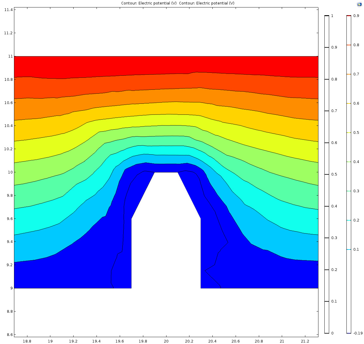

Hello Robert,
Thanks a lot for your suggestion. I tried changing the mesh settings and I am getting the desired output now. Thank you so much for the help.
