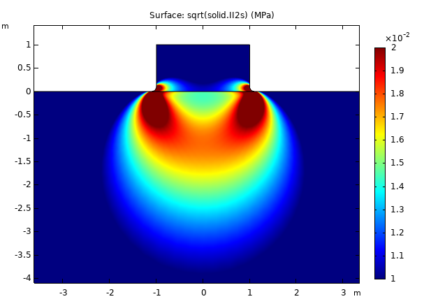

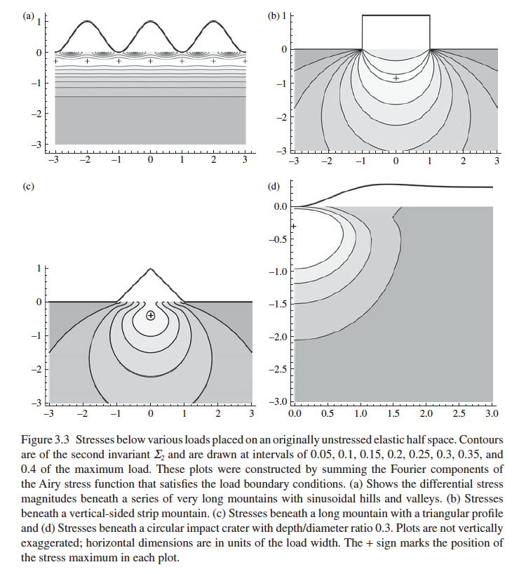

I'm trying to model a load (a long mountain with vertical sides) placed on an originally unstressed elastic half space. I know what the solution should be based on an analytical solution. The solution I'm getting with COMSOL doesn't match that. Instead of peaking slightly below the mountain, the 2nd invariant of the stress just keeps increasing deeper in the halfspace. One issue I've thought of might be that the "half space" part in the COMSOL model isn't a semi-infinite halfspace just a very large domain with respect to the moutain, but trying to make the space larger leads to increasingly high stresses throughout. I'm also not certain what the boundary conditions for this finite space should be; I've tried having only the top surface free with the others fixed (as in the attached image) as well as having top and sides free or top and bottom free and none give a stress distribution matching the analytical solution. I'd appreciate any insight into why the COMSOL solution might be different than expected.

Hi Claire,
You are not solving the same problem as in the text book.
Now comes the interesting part: You are solving the correct problem from a physics point of view; the text book is not.
If you look at the stress contours in the text book, it evident that this is the effect of a force distribution on the surface, and not from actually having a mountain there. The caption under the figure actually says “Stresses below various loads…”
However, as you have noticed in your solution, the stress distribution when the mountain is included is quite different. The solution in the nearfield (which is the relevant part) is not even close to the textbook solution. The textbook solution is the mathematical solution to a different problem, one which is not relevant for the real-world problem.

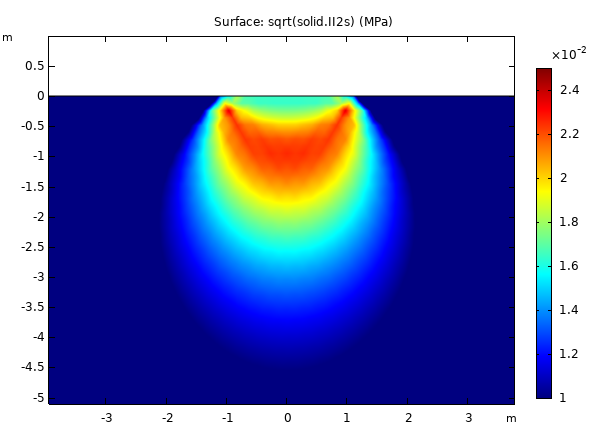

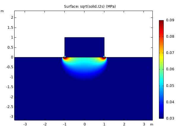

Posted: 6 years ago 18 mars 2020, 17:27 UTC−4
Hi Henrik,
Thanks for your reply and pointing me toward the right boundary conditions for infinite half spaces.
The caption seems a little ambiguous to me, but it does sound like they might have just been considering a surface load distribution in the book. To check whether I got the solution from the book if I did that in COMSOL, I tried just setting a boundary load condition based on the weight of the mountain on the boundary between the mountain and the halfspace instead of applying gravity to both as I had been. The solution for the second invariant of the stress (which is what the book indicates is being plotted) doesn't look like the solution in the book but the solution for the second invariant of the deviatoric stress does look rather similar (except for higher stresses under the corners of the mountain). So maybe that is what the book is really showing.

Posted: 6 years ago 19 mars 2020, 03:20 UTC−4
Well, to get the text book solution, you should actually remove the mountain altogether. And just use the load.

Posted: 6 years ago 19 mars 2020, 12:48 UTC−4
I think you're right, when I remove the mountain and just use the load, the solution looks basically just like the book solution. Thanks for your help understanding this.
