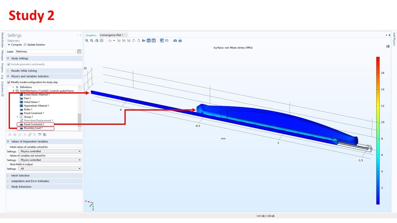

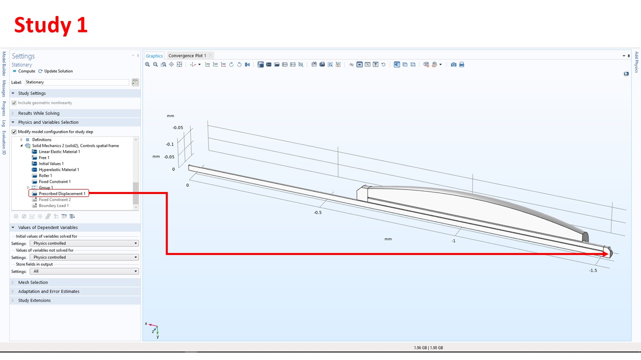

Hi, I am looking for the steps needed to reuse a deformed hyperelastic shape with stress results created in response to a prescribed displacement, for a second simulation with new boundary conditions. Thank you in advance,

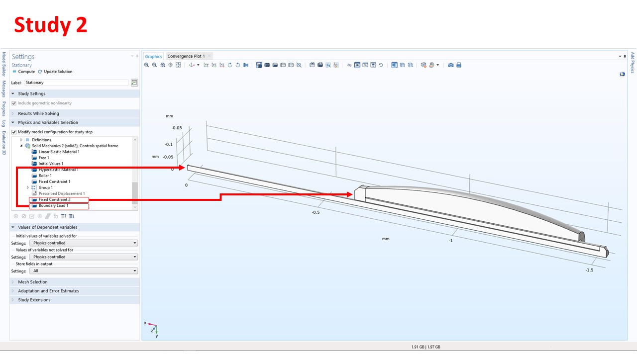

I am just trying to Disable the Prescribed Displacement of Study 1 Enable the Fixed Constraint Boundary Load of Study 2, and apply to the deformed shape with stress results of Study 1.
Hi Mr Henrik I am just trying to Disable the **Prescribed Displacement** of *Study 1* Enable the **Fixed Constraint** **Boundary Load** of *Study 2*, and apply to the deformed shape with stress results of *Study 1*.

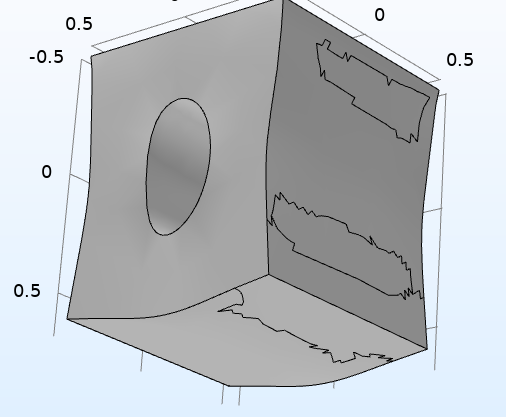

Hi, I would like to simulate the band gap of a deformed phononic crystal. Firstly, I will simulate the deformation of the porous structure under the external load, and then, the deformed structure with initial stresses can be useded as the new geometric input for the next step. I see the details in the following blog post: www.comsol.com/blogs/how-to-reuse-a-deformed-shape-as-a-geometry-input/. However, when I use this technique, several strange lines are at the surface of the input model. Moreover, this input model has no initial stresses. So how can I export the deformed structure with initial stresses for next study? Do you have other methods? Thanks in advance. Best regards, Haishan Tang

Regarding the last update of my inquiry, I solved by some simple steps, First, instead of two 'Stationary' simulations, I used one 'Time-dependent' to integrate a sequence of simulations. Second, Instead of the 'Prescribed Displacement', I used 'Boundary Load', and by this, I could eliminate the applied force gradually during the simulation by using an 'Interpolation' function, which is not possible by using 'Prescribed Displacement'. (The same idea of M. Henrik I think.) And third, placing anchors to hold the new deformed shape during the simulation. I hope this will help the future reader,
