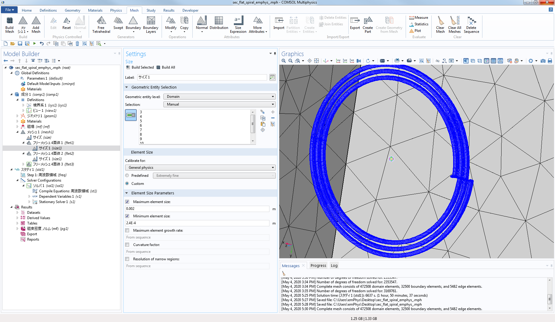

I played a little with your iterative setup and with a little mesh refinement on the coil domain it converges. It took 450 iterations and almost 2 hours on my machine, but needs less than 13 GB then. Maybe you can tweak that a little. The screen shot shows the only modification I did to the mesh. I didn't touch the solver. This is the model you posted first.
Cheers Edgar

Thank you for your teaching. I tried to change the mesh like your screen shot. But It did not converge. I will try other meshes.
