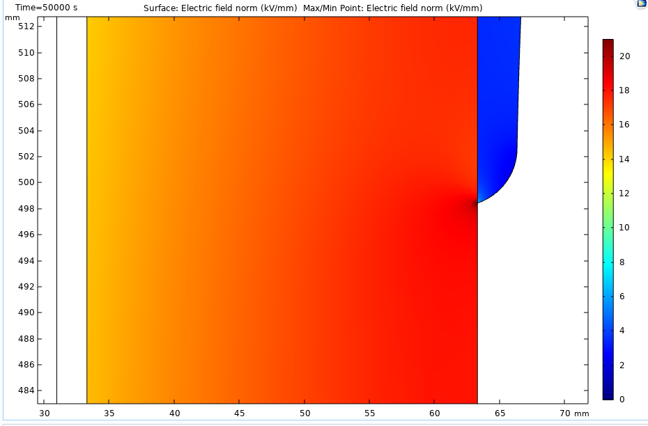

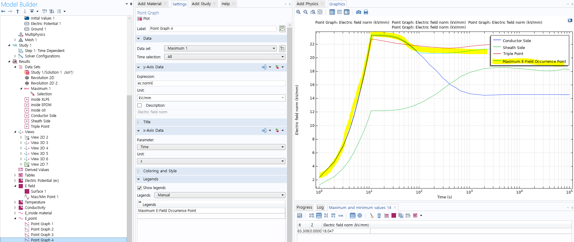

In this time analysis, the field was focused on the triple point when visually checked But maxpoint indicates elsewhere. I checked the triple point separately, and could confirm that it also greater than max point. Also, the value of the maximum data set was less than the value confirmed by a separate point.
I checked the electric field with ec.normE Am I mistaken about the max or field function?

This is probably a question about averaging. The max value in a point is computed as the maximum of the average of the domains meeting at the point.
The same is true for point graph, for example.
A surface plot, however, will not (by default) make such an averaging. You can also see this if you use a Max/Min Surface plot, which is a better choice in your case.

Hi Henrik, thank you for your help. The problem was solved by using Max/Min Surface plot.
Also, the problem of maximum data set was solved in the same way. At first it's Geometry level was set to 'Take from data set (sol1)'. I changed this to Surface and then the problem was solved.
