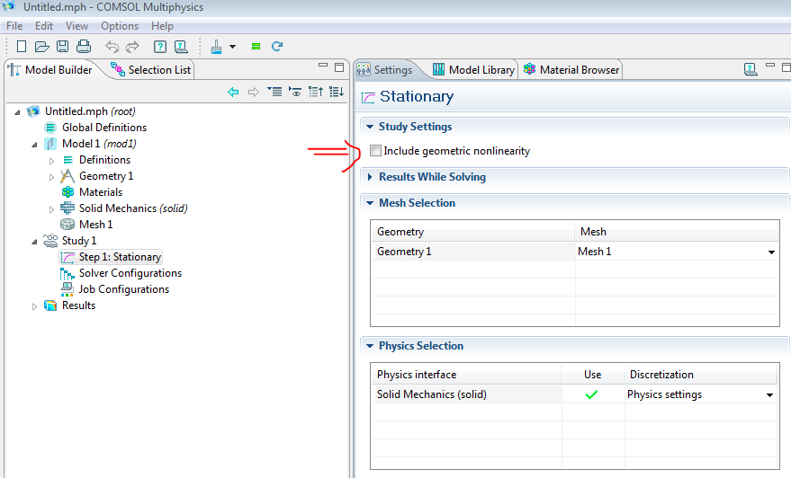

When I download the support file for the Large Deformation Beam model, I do see this button.
However, if I delete the stationary solver and add a new one, I do not see the button any more.
It seems like I must be doing something dumb here, but I can't seem to figure out what. Any help would be appreciated.

it could be a version issue, as these changes vere brought in in 4.2 or 4.2a (have forgotten which one exactly) and older versions put the non linear button in the linear elastic material subnode of solid. By the way I understand it as two non linearitites, the stress representations (with or without cross derivative terms) and the large geometrical deformations.
Be sure you have a newly patche 4.2a (mine is 166 today) and that you reconstruct the model from scratch (do not change an older version, I never trust that fully, at least not for pre 4.2a versions
Thanks for the quick reply. Unfortunately, this did not solve my problem.
I am using version 4.2a and the most recent patch (166). However, I still do not see anything that says "Include Geometric Nonlinearity" under the "Stationary" subnode (even when I create a new model from scratch). I also checked the "Linear Elastic Material Model" subnode under the solid mechanics node, but didn't see anything there, either.

I do (if I select solid, it depends on the physics (also .166 on Win-7)
I don't (even when I select solid, on a Mac)

I have the same problem when I use "beam" model. I am using 4.3a on win vista. There should be a way to select "geometric non-linearity" option when I am using beam model too.
I have to say that I don't have this problem when I use "solid mechanics" model, but when I use "beam" or "plate" models that option disappears!!!
Please help
The Beam interface does not support geometric nonlinearity, so in a model with only a beam interface this option is not available. For the plate interface it should be there, though.
