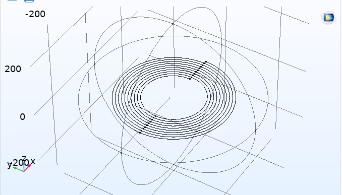

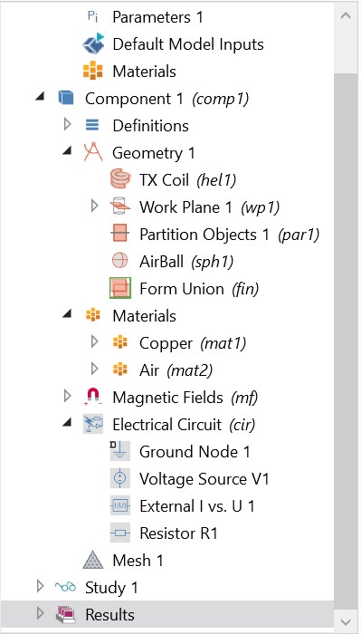

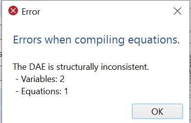

Hi, I'm new here and still struggling to figure out the step by step process to run a simulation. I'm trying to simulate a magnetic field from feeding a Sine AC wave to a copper coil. I've generated a Helix (copper) and a Sphere (air) around it. I used a partition to separate the coil into two sides, and conencted the P node of the Voltage Source to one side, and the N node of the Voltage source to the other side. I've been receiving the 'Error when Compiling Equations: The DAE is structurally inconsistent.' message no matter how i try to change the nodes. I've attached screenshots below. Any help would be greatly appreciated. Thank you!
