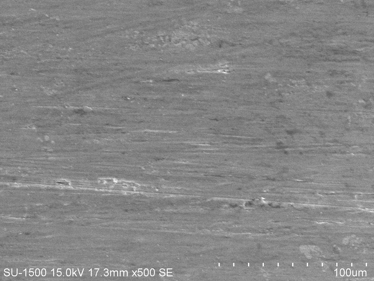

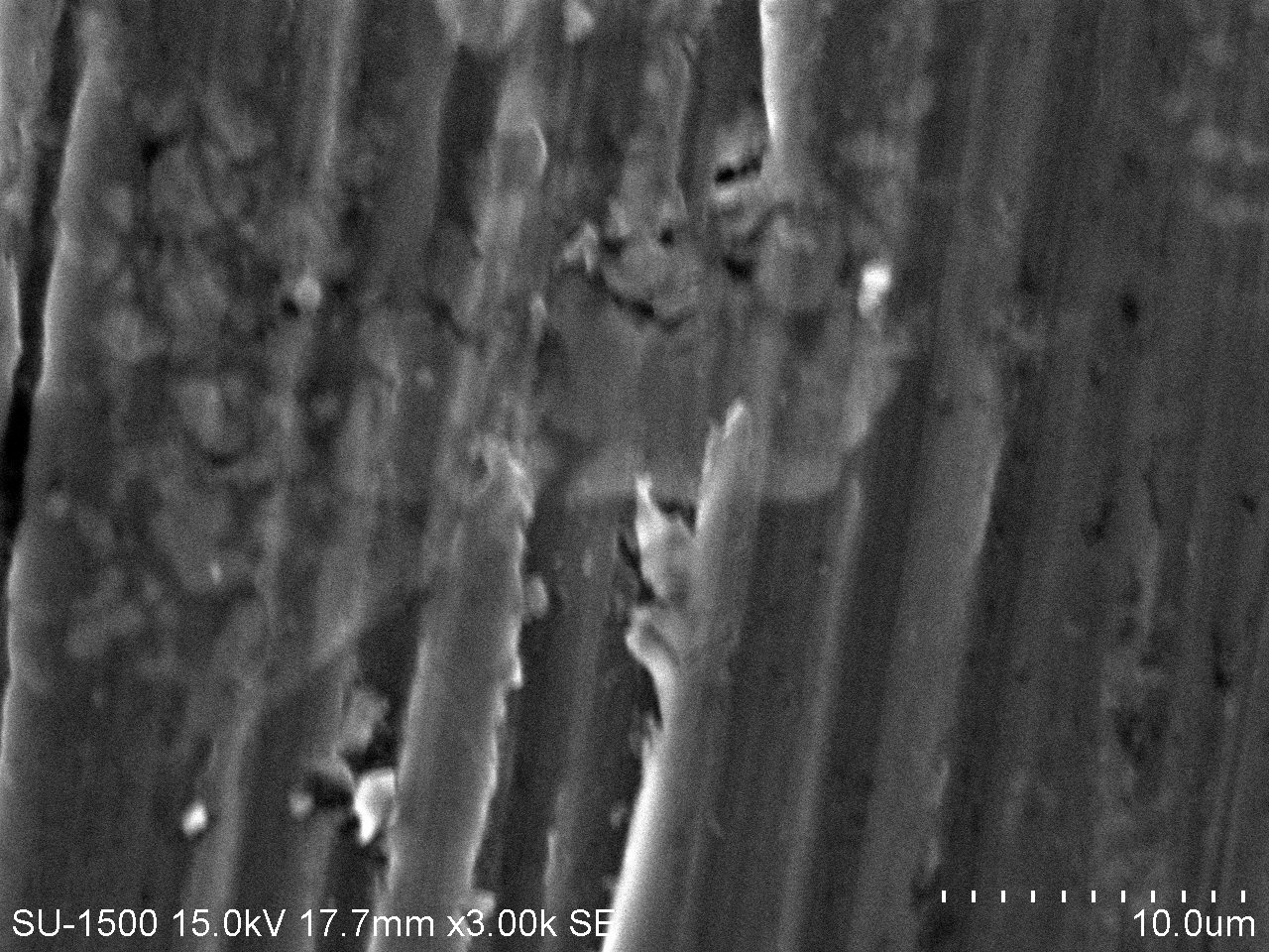

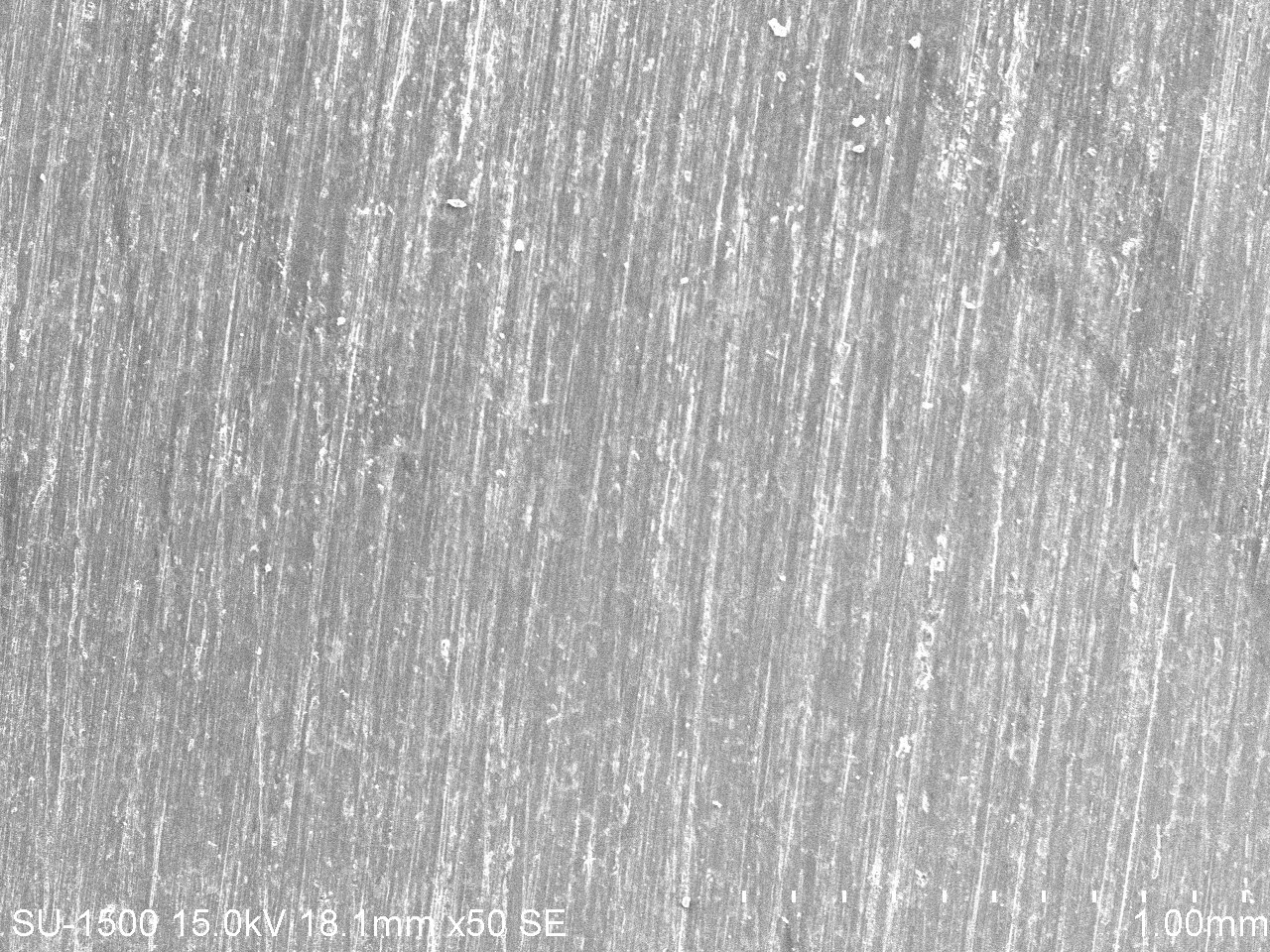

Hi I have SEM report which is in jpg format these image has to be imported to the comsol so that i have to define material . it is a composite of two material, i am finding thermal residual stress on it,,please tell me how to proceed. and how i can change the temparature parameter.
Posted: 1 decade ago 21 avr. 2015, 06:20 UTC−4
files are attaached
Hi I have SEM report which is in jpg format these image has to be imported to the comsol so that i have to define material . it is a composite of two material, i am finding thermal residual stress on it,,please tell me how to proceed. and how i can change the temparature parameter. files are attaached
Posted: 1 decade ago 21 avr. 2015, 07:51 UTC−4
You can define an Image function and use the value from it when setting up your physics.
Posted: 1 decade ago 21 avr. 2015, 10:50 UTC−4
On the subject of JPEG: it's dangerous because JPEG contains compression artifacts: anomalous oscillations in intensity near edges. PNG is better. But you can trivially convert between image types with a suitable software, for example "ImageMagick" tools, in particular "convert", does it quickly and effectively. Then you don't need to worry any more about JPEG load-save cycles causing further degradation to your data.
I'm very interested in this subject myself. In computer graphics, for example POV-Ray, there's the notion of a "bump map" which perturbs surfaces along their normal using an image. In POV-Ray it's done using a linear perturbation applied to the scattering direction of light. But it could also be applied to a displacement field. The challenge is mapping a 2-dimensional image to a 3-dimensional surface. For example maps between a 2-dimensional map and the near-spherical earth surface is a nontrivial topic.
Anyway, I'd just convert the images to PNG.
