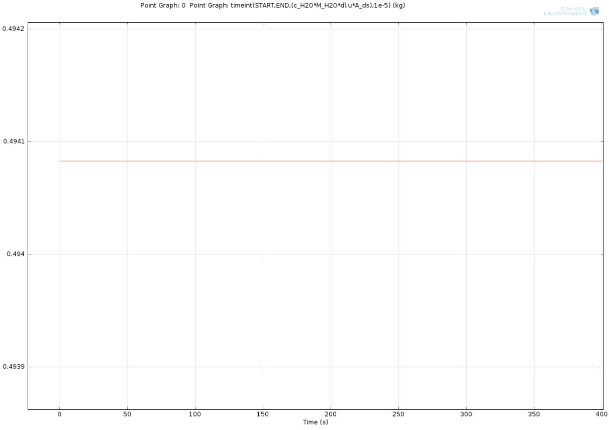

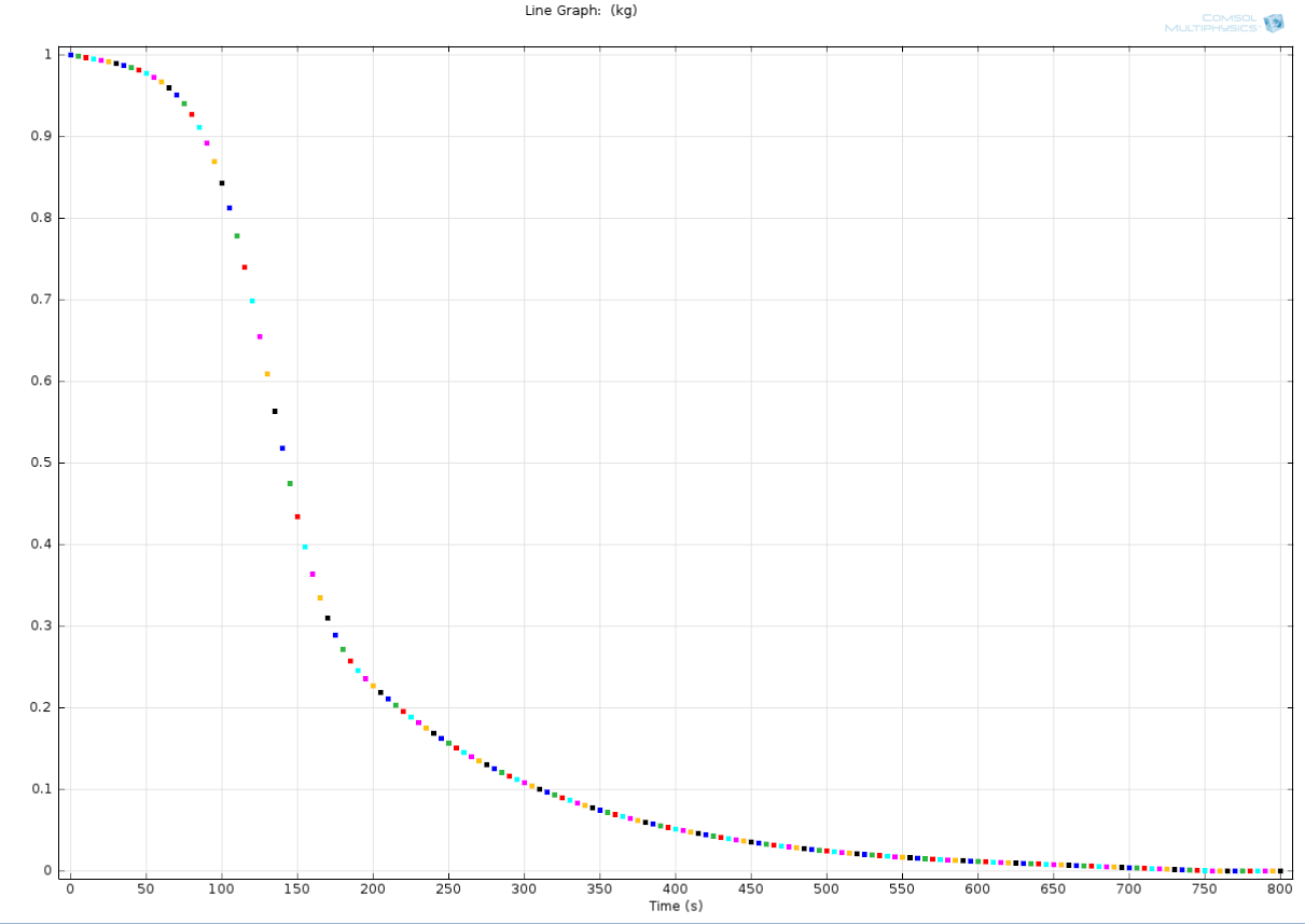

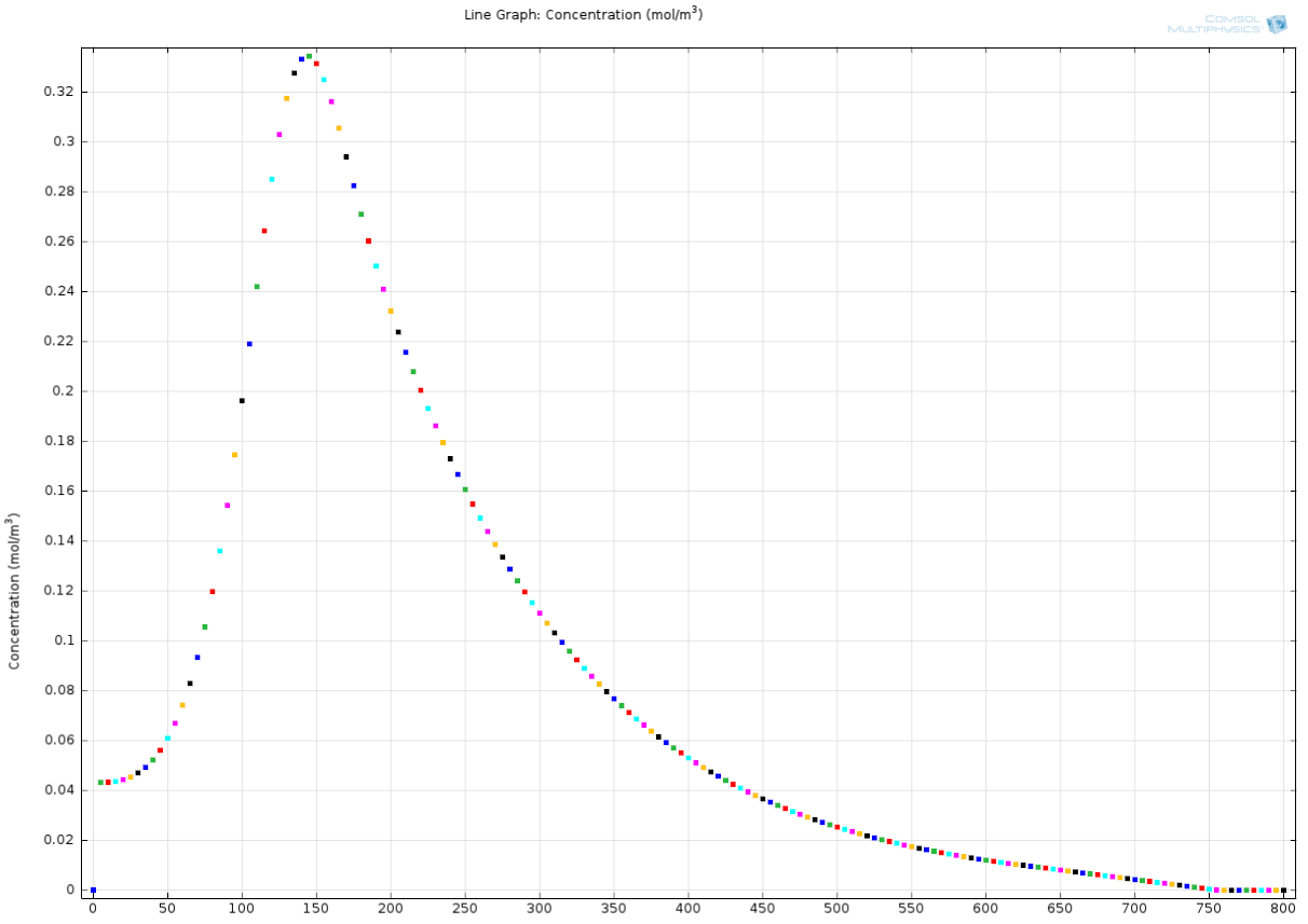

It must have something to do with temperature, because it did work when T was constant and now it doesn't since T is a function. Included in this post is the actual model (4.2a) and some graphs.
The first graph shows my own calculation of the amount of water left in the solid, this goes to 0, like it should.
The second one show the time integral over the exit and this is 0.49 kg while it should be 1 kg.
The third has the same problem.
The last one shows the H2O concentration in the entire reactor vs time. Most important is that is goes to zero, so apparently all mass flows out of the reactor.
