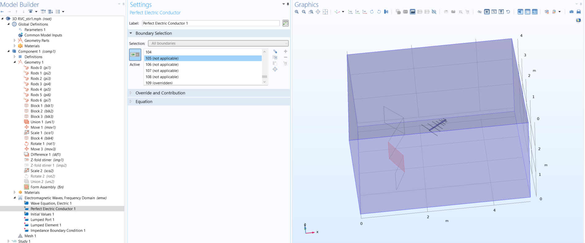

I am looking into the effect of adding a mode stirrer to a room excited by a Log-periodic antenna on the electric field in the room. I would like to see how the electric field would change between two stirrer positions. However I am experiencing difficulties adding the mode stirrer and getting two solutions (I start with turning the mode stirrer 180 degrees).
I created the geometry of the mode stirrer by defining a workplane and specifying rectangles in this workplane which I then manipulate such that they form the form of the mode stirrer. This stirrer is then considered infinitely thin to ease the computational requirements. I then try to add boundary conditions to this geometry (PEC/Impedance) but they are not applicable. I added a screenshot for clarification.
If I use very thin rectangular blocks instead of the planes I can apply the boundary conditions however the mesh becomes incredibly fine because of the thinness of the blocks causing very large computation times which I want to avoid as much as possible.

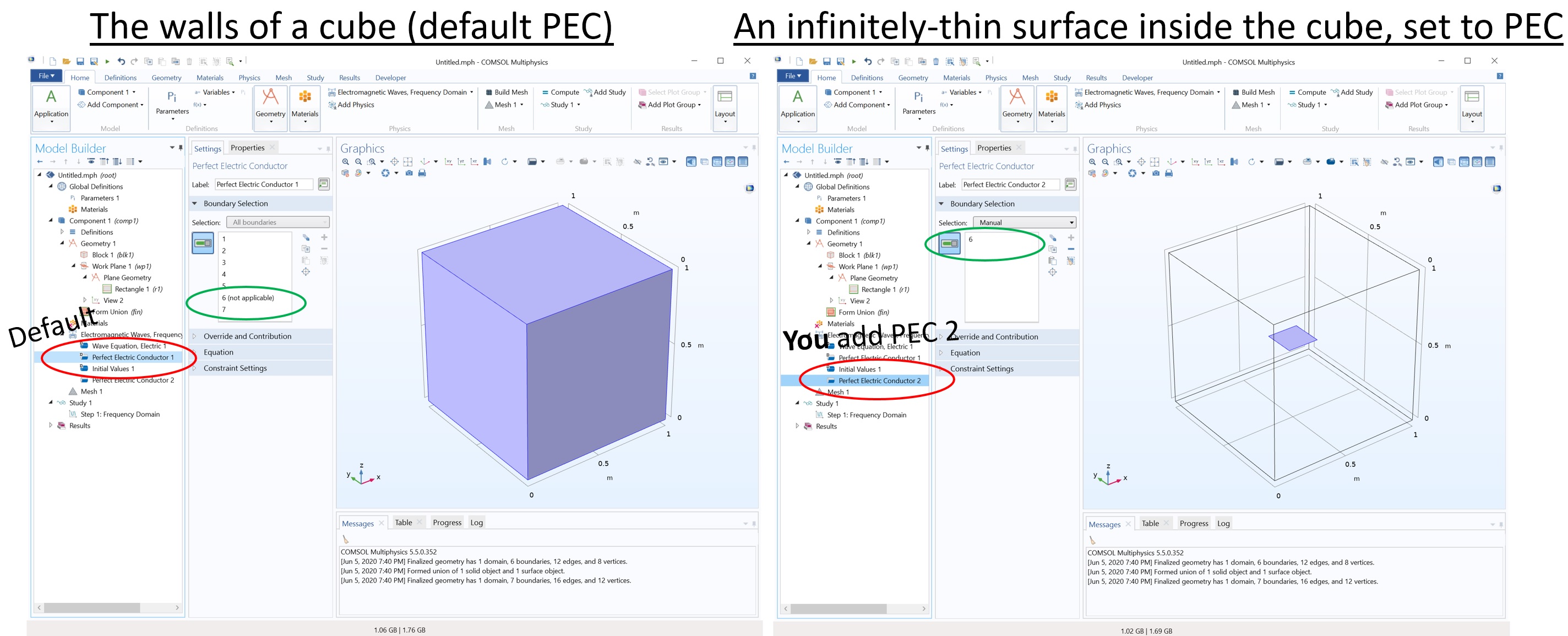

You are welcome. I should add that, in principle, you can use an infinitely thin surface, but to set it as a PEC, you will need to create a separate PEC boundary condition for it. E.g., see the attached figure for how to do that. Personally, I prefer to represent most real-world 3D objects by 3D geometries, when working in a 3D model. But again, you don't necessarily have to do that.
You are welcome. I should add that, in principle, you *can* use an infinitely thin surface, but to set it as a PEC, you will need to create a separate PEC boundary condition for it. E.g., see the attached figure for how to do that. Personally, I prefer to represent most real-world 3D objects by 3D geometries, when working in a 3D model. But again, you don't necessarily have to do that.
