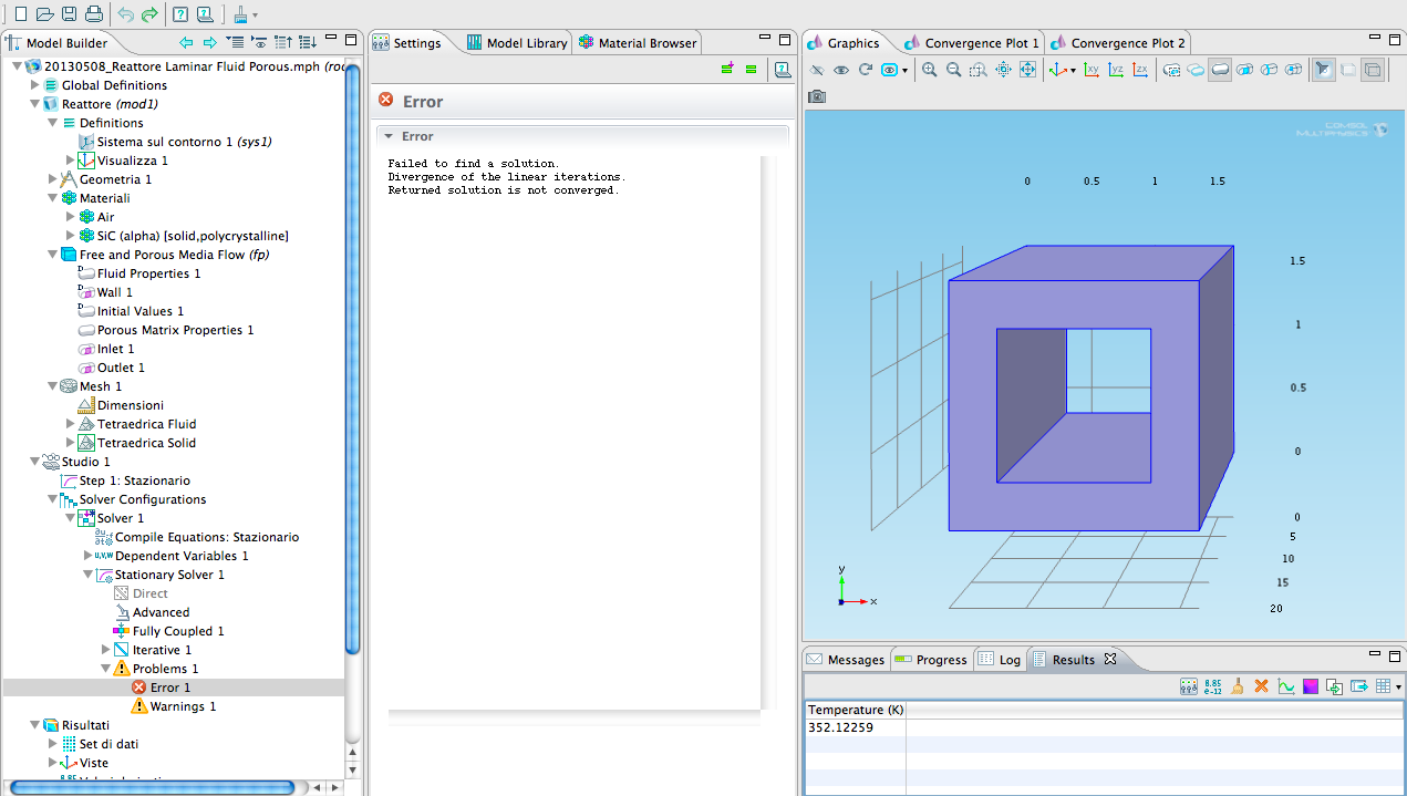

Also my solver doesn't converge (Image attached) with this physics.
The error message is:
"Failed to find a solution.
Divergence of the linear iterations.
Returned solution is not converged."

Also my solver doesn't converge (Image attached) with this physics. The error message is: "Failed to find a solution. Divergence of the linear iterations. Returned solution is not converged." My problem is to simulate the flow of air through a square channel and a porous solid (SiC). I'm trying to use the physic "Free and Porous Media Flow" (Domain: All) - Fluid Properties (Domain: All, pressure fp/fp1) - Porous Matrix Properties (Domain: 1, Porous Material SiC, Porosity 0.5, Permeability e-10) - Inlet (5m/s) - Outlet (P=0) - Initial value (P=0 u=0) Are these settings and boundary conditions correct?

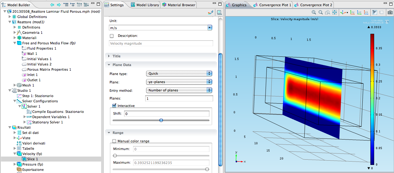

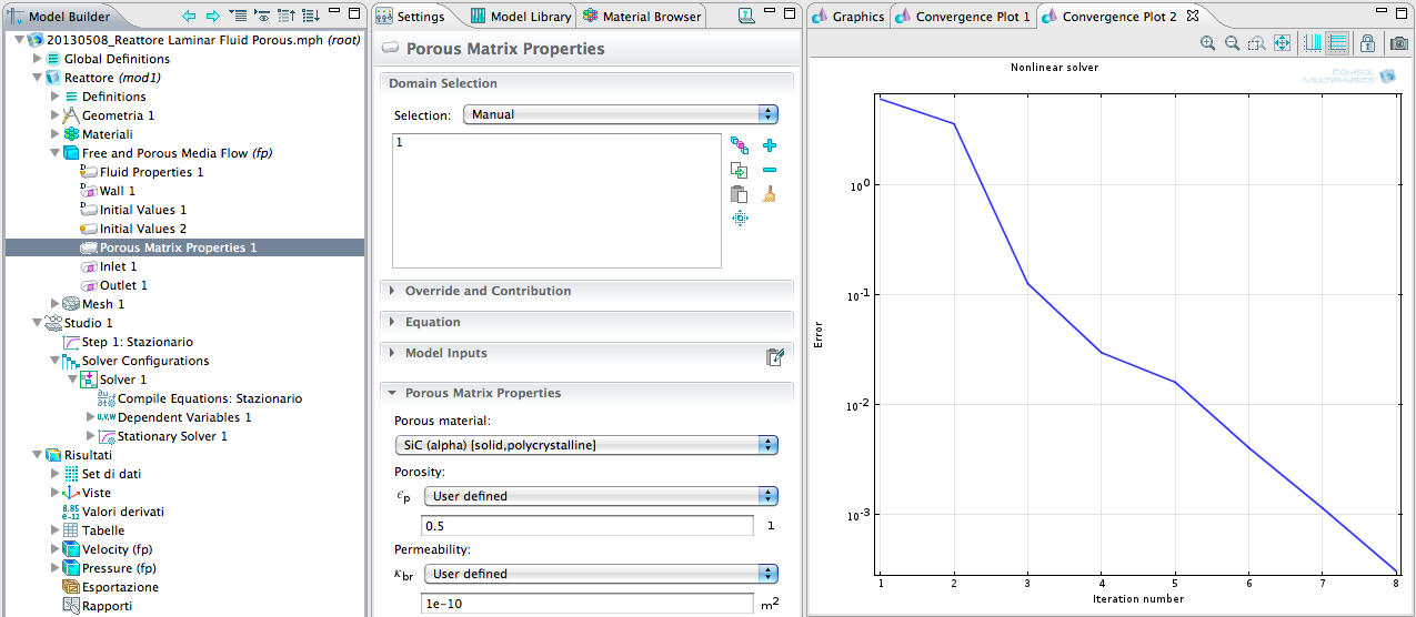

I initialize the flow with a velocity as 0.1 in the axial direction as you suggested to me and it works with a permeability of 1e-10 m2 (Permeability_1e-10.png.png)
In every way the velocity slices don't show flow in the porous media around the open channel. (velocity_Permeability_1e-10.png)

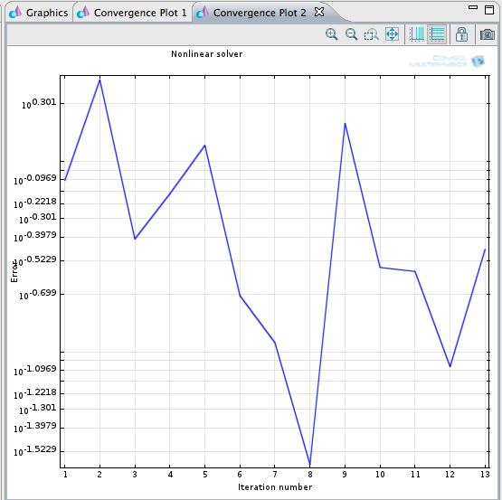

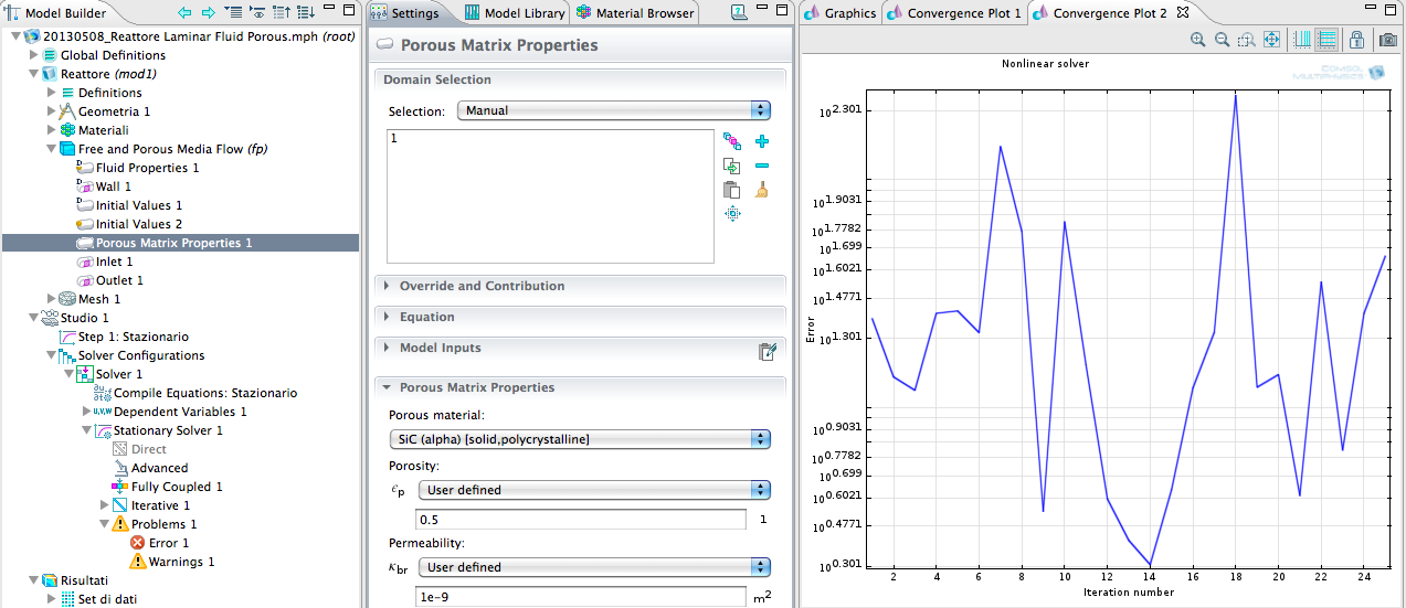

First of all I tried to change the permeability, but as I increase it the system doesn't converge (Permeability_1e-9.png).

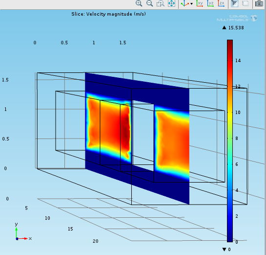

My second solution was to insert a solid cubic obstacle in the free channel to force the fluid to go through the porous media. As the fluid approaches the obstacle the velocity goes to zero, but inexplicably v goes to zero in the porous wall to recover it's value after passing the cubic. (Cubic obstacle.png)
How is it physically possible?
What is wrong with my settings?
