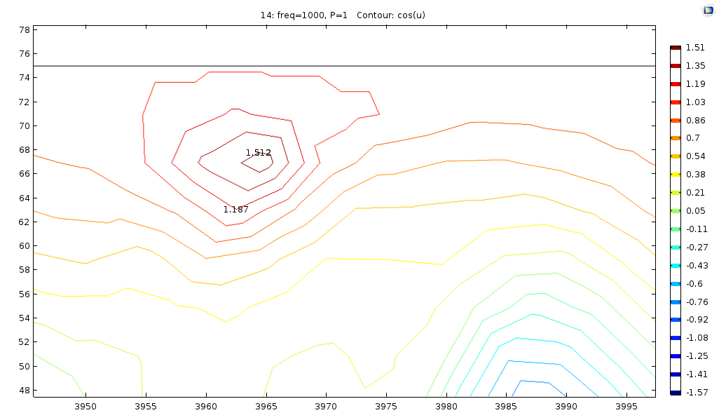

Why is cos(u) giving me a result bigger than 1.
Fernando J. Pena Cantu
I am doing the contour plot of one of my solutions. There contour plot is cos(u) where u is my soltuion. The problem is that the results of show that cos(u) can be larger than 1 in certian areas. Which is impossible regardless of the value of u. What is going on? I have attached a picture.
My version of comsol is 5.2

real(cos(u)) can be larger than 1 if u has a nonzero imaginary part. You can check if this is the case by creating a surface plot of imag(u).
