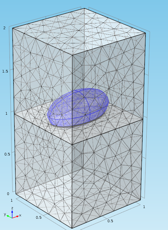

I have created a 3D model with rectangular blocks and an ellipsoid on the top surface of the block (with half inside the block and half outside the block).
When I choose automatic physics based meshing, I am getting the following error "Internal error in boundary respecting" at the boundaries of the ellipsoid and the rectangular block top surface.

I have probably not manange to reproduce your geometry, as my test is meshing, automatically as well as manually, even with a boundary mesh around the ellispoid.
But there can be cases where the mesher has issues, such as tangeant curved surfaces touching at one "point" and not over a surface, looped geometry (thorus or doughnut shapes) etc. Often you can get away by eiterh using a finer mesh or by manually meshing the parts starting in the inner and going outwards by layers. Or even by cutting the geometry by a or a few planes to have smaller parts/domains to mesh
