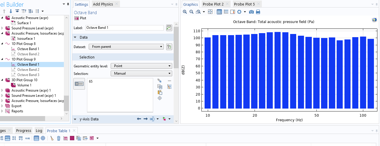

Thanks for the reply,
I'll explain you. I am trying to optimize a room low band frequency response. When I measure the acpr.p_t in octave bands then the variation is quite huge, around 20-25dB. But when I just change it to acpr.Lp(Sound Pressure Level) then it gets changed to a target error of around 1-2dB.
I am new to Comsol and didn't find a good difference between Total Acoustic Pressure Field(acpr.p_t) and Sound Pressure Level(acpr.Lp) in the user manual as well. What I mean is the that the relative distribution should not change when we change the units. Am I right? I have attanched reference images for both. Please check if you guide me on this.
