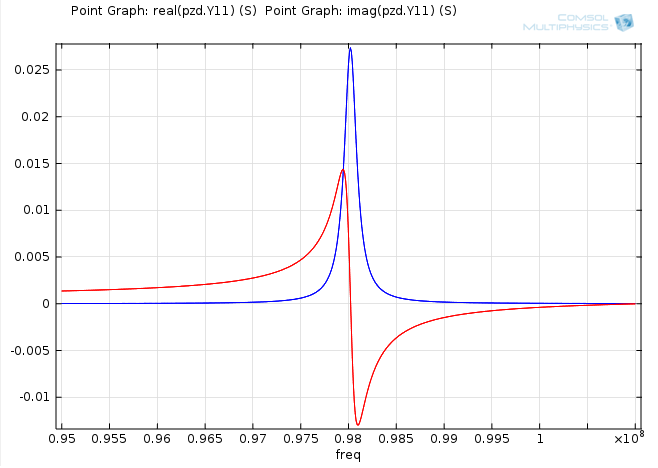

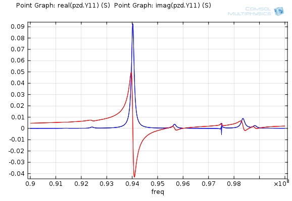

Here are my files. IDT Celda Unitaria is a single IDT, I have performed a frequency analysis to see the admitance. I Also attached this graphic (Admitancia IDT celda con 60 Lambda) . Prueba SAW IDT is a 10 electrodes IDT, with this I have a problem with PML boundaries that I used to avoid the reflections on the material frontiers (The error i get from comsol is "Comsol could not find any spherical or cylindrical regions."). Al so I Attached the results about admitance (Admitancia IDT 10 Electrodos ...).
Please, let me know if you can resolve the problems with PML. I am using COMSOL 4.2a
