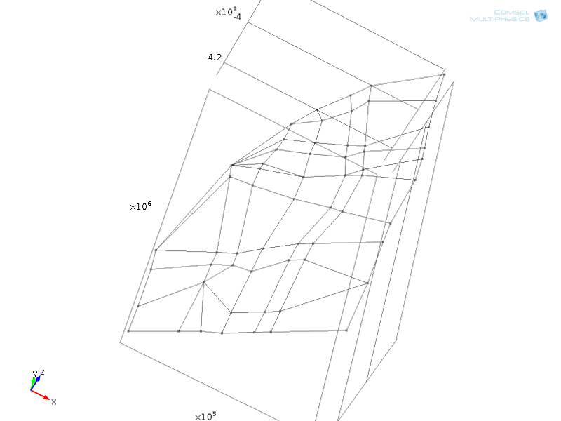

I read an article, saying that by creating Bézier curves, both horizontally and vertically, at which all control points are corresponding with each other, the last curves drawn will form a Bézier surface.
Please see attachment. :)
I did but the whole Bézier polygon seems to be consisted of edges and not yet a surface. Any advise?
ps: I move on trying 'interpolation curve' while waiting for your inputs.
Many thanks!!!!!!!!!!
regards
Liwah

updates --
Interpolation curve seems to be not working as well. Not too sure if 'parametric surface' helps but to create a particular surface geometry, I am afraid that I could not simply use a formula ('expression').
If I stick with 'Bézier polygon' to create Bézier curves, how to make them into Bézier surfaces by the end?
many thanks!!
regards
Liwah

I tried 'convert to surface' as well as 'convert to solid', the whole thing (as per previous attachment) just disappeared. If I tried with higher default relative repair tolerance, COMSOL ceased
Itself.
any advise? many thanks!!
Regards
Liwah

hi there
extruded 3D element is a flat plane, I did that for some of my 3D elements. Yet, I need deformed surfaces which could not be extruded from a workplane. I am now trying to create these deformed surfaces from, for instance, hexahedrons (several hexahedrons together forming one deformed surface). Now, my problem is: unable to form union without errors.
any advises are appreciated!! thanks!!
regards
Liwah
