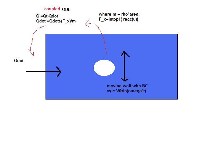

I am using coupled ODEs in my 2D spf laminar flow. My results are exactly varying 2e3 with theoritical ones. I feel that it is due to dimensions. Would you please illustrate how do we nondimensionalise newton's equation?
For example:
mXdott=F
in 2D spf, we can use 'm' as mass per unit length, rho*Area for left hand side. F is calculated from line integral of reacf(v). If so (m being mass per unitlength, F being force per unit length) the above equation is already balanced to give Xdott in m/s2, Xdot in m/s?
Please clarify my doubt.
Thanks in advance
Siva
Dr. Ivar, I am using coupled ODEs in my 2D spf laminar flow. My results are exactly varying 2e3 with theoritical ones. I feel that it is due to dimensions. Would you please illustrate how do we nondimensionalise newton's equation? For example: mXdott=F in 2D spf, we can use 'm' as mass per unit length, rho*Area for left hand side. F is calculated from line integral of reacf(v). If so (m being mass per unitlength, F being force per unit length) the above equation is already balanced to give Xdott in m/s2, Xdot in m/s? Please clarify my doubt. Thanks in advance Siva

I think I failed to explain my problem clearly. As you know, mine is a 2D spf laminar flow. I have used moving wall BC for an ellipse in body-fitted frame with prescribed y-component of velocity(Please see the attached figure). The x-component of velocity of ellipse is calculated through ODEs. I have used model couplings-> integration and global equations. I have defined a state variable called 'Q'. this is infact position 'x' to avoid confusion with variable names, -this I learnt through one of your earlier posts.
The ODEs were : Q: Qt-Qdot; Qdot: Qdott-(F_x/m). I have calculated F_x using intop1(-reacf(u)) and m using rho_solid*area. Then Newton's equation: mQdott=F_x is supposedly dimensionally correct.
My results (Qdot, ie. x-component of velocity) are varying exactly x2e3 for all parametric solutions with mu=0.01[Pa*s], area=0.07[m^2], rho_solid = 32*rho_fluid, rho_fluid = 200,1000,1600,2000 [kg/m^3].
I am not sure, why there is a constant difference 2e3 for all parametric variations. Did I miss anything in ODE?
Thanks again dr. Ivar.
The physics challenges me everytime, it even shakes my fundamental understandings. You alone can help me.
Thanks a lot Dr. Ivar This IS called discussion. You have illustrated the entire situation in a beautiful manner. Every word is worthy of 100 books. Hats off to you for such elaborate reply. I think I failed to explain my problem clearly. As you know, mine is a 2D spf laminar flow. I have used moving wall BC for an ellipse in body-fitted frame with prescribed y-component of velocity(Please see the attached figure). The x-component of velocity of ellipse is calculated through ODEs. I have used model couplings-> integration and global equations. I have defined a state variable called 'Q'. this is infact position 'x' to avoid confusion with variable names, -this I learnt through one of your earlier posts. The ODEs were : Q: Qt-Qdot; Qdot: Qdott-(F_x/m). I have calculated F_x using intop1(-reacf(u)) and m using rho_solid*area. Then Newton's equation: mQdott=F_x is supposedly dimensionally correct. My results (Qdot, ie. x-component of velocity) are varying exactly x2e3 for all parametric solutions with mu=0.01[Pa*s], area=0.07[m^2], rho_solid = 32*rho_fluid, rho_fluid = 200,1000,1600,2000 [kg/m^3]. I am not sure, why there is a constant difference 2e3 for all parametric variations. Did I miss anything in ODE? Thanks again dr. Ivar. The physics challenges me everytime, it even shakes my fundamental understandings. You alone can help me.

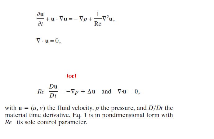

I want to non-dimensionalise Navier-Stokes equation using Reynolds number.
Is there a way to change Navier-Stokes equation in nondimensional form as in the attached figure?
thanks a ton for your helps...
Yes. I got it. I want to non-dimensionalise Navier-Stokes equation using Reynolds number. Is there a way to change Navier-Stokes equation in nondimensional form as in the attached figure? thanks a ton for your helps...
Lechoslaw Krolikowski
Posted: 1 decade ago 20 mars 2012, 17:04 UTC+1
Suppose we want to solve transient laminar flow problem (NS equ.+BCs+IC). Our problem has usual dimensional form but we want to solve it as dimensionless. To this end we must perform two tasks:
1. Change the dimensional problem for dimensionless one. This is the analytic task.
2. Solve the dimensionless problem. This is the numerical task.
It is not clear to me which of these task you want to perform. First? Second? Both?

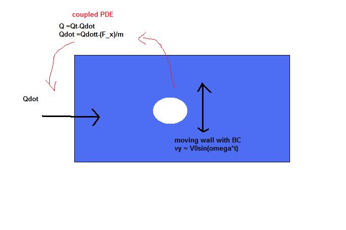

Actually my problem is 2D laminar flow of oscillating circular cylinder. The horizontal reaction force is coupled so that due to vertical oscillation horizontal movement take place. I have created coupled modelling as in the attached figure. My result varies 2e3 times exactly with all paramteric variation.
I was thinking of non-dimensionalising the whole model and run simulation. dont know how to do that.
Please help me.
Hi. Thanks for your reply. Actually my problem is 2D laminar flow of oscillating circular cylinder. The horizontal reaction force is coupled so that due to vertical oscillation horizontal movement take place. I have created coupled modelling as in the attached figure. My result varies 2e3 times exactly with all paramteric variation. I was thinking of non-dimensionalising the whole model and run simulation. dont know how to do that. Please help me.
