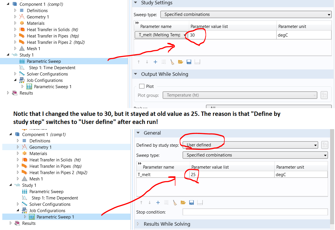

Hello, I'm using Parametric Sweep alot, and I've notice very annoying bug (or it is just my bad). Here is the senario of the problem: 1. I set up a Parametric Sweep for first time. It worked just fine. 2. I needed to change the value in the "Parameter Value List", and run it again. However, I found out that COMSOL used the old value not the new one. The reason I found is in (Parametric Sweep under Job Configurations node). After each run, this node swiches to "User defined" instead of staying as "Parametric Sweep".
In short, the problem is that after each run, I have to remember to go to (Parametric Sweep under Job Configurations node) to change it back to "Parametric Sweep". Why does it swich after each run to "User Defined"?

I have noticed that changes the Parametric sweep settings are not automatically updated to job configurations.
