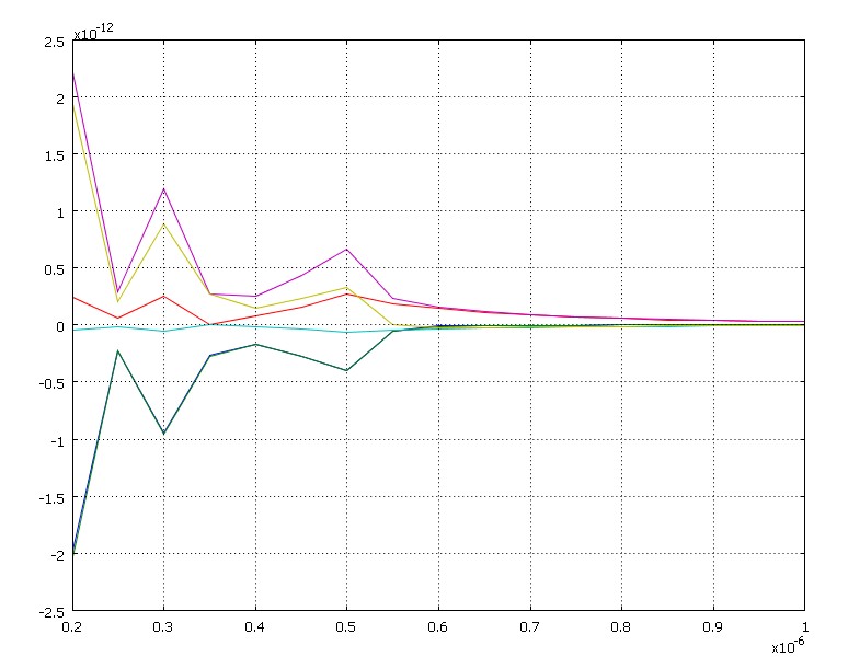

There is serious discrepancy between my results and in results given in the presentation (different field enhancment and cross-sections that are negative at some wavelengths). I used my own data for the refraction index though it also was teken from johnson&christy (1972) paper - I've built interpolated functions with dependence on the wavelength.

I have the same problem with the model; for some wavelengths the scattering cross section becomes negative which makes, of course, nonsense. First I thought it was probably a mistake I made while defining the global expressions or the integration ones, so I repeated the process several times but I obtained the same result over and over. Later I thought that maybe one of the steps in the documentation file was wrong, so I ended downloading the file .mph directly from the model gallery instead of trying to reproduce it myself. Everything was already defined in the file so I just had to mesh the model and solve it. To do so I followed the instructions (mesh size, number of layers in the exterior subdomain, solver parameters,...) exactly as they were written in the documentation. It was a big surprise to find out that I had exactly the same problem as before. I wanted to attach the scattering cross-sections obtained with the downloaded file (Mie_scattering_plasmonic_reset_35a1.mph) to illustrate the problem but the attach button is not responding. Anyway, any idea about what could be wrong?
