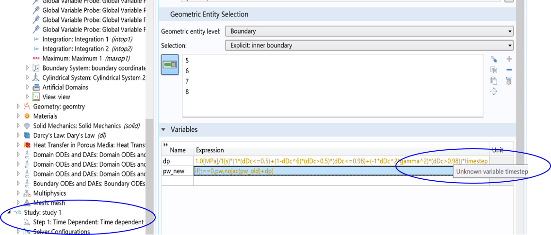

Thanks for your reply, Magnus. I am sure that i used a time-dependent solver in my study. You can see from the attached screenshot.
Thanks,
All the best,
Songcai
Thanks,
All the best,
Songcai

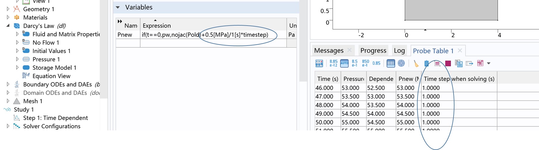

Hi, Magnus. I see what you mean, but I have just tried it in version 5.6, it works well. The screenshot from version 5.6 is attached. Of course, it is applicable in Comsol 5.4 as well.
Thanks,
All the best,
Songcai
Thanks,
All the best,
Songcai
