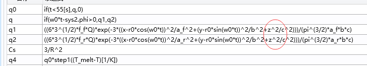

My double ellipsoid heat source can move in the ring direction, but it cannot be offset in the axial direction. I change Z+ or-a certain value, but it can’t be achieved. Can anyone help me see it? Thank you very much.
