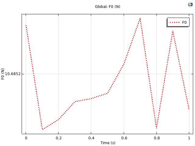

The attached project has single magnet and no other objects. With the "Magnetic Field" physics we expect to see zero magnetic force, but the graph of force after simulation shows a noisy, about 10N force.
What I am doing wrong?

Hmm. If I move your magnet up to the vertical center (pos z = -.01 instead of pos z = -.09) of your model, then the force drops by a factor of about 20x. This suggests that this asymmetry in the force was due to imperfections (the vertical asmmetry) in your model. Boundary conditions can never truly represent free space. Also, using finer meshes and higher order discretization reduces the force even further. So... it looks like you have numerical effects involved. You'll likely never get a "true" zero. This is a finite-element method based code.
By the way, why are you doing a time-dependent study on what seems to be a steady-state problem? Did I miss something?
Hmm. If I move your magnet up to the vertical center (pos z = -.01 instead of pos z = -.09) of your model, then the force drops by a factor of about 20x. This suggests that this asymmetry in the force was due to imperfections (the vertical asmmetry) in your model. Boundary conditions can never *truly* represent free space. Also, using finer meshes and higher order discretization reduces the force even further. So... it looks like you have numerical effects involved. You'll likely never get a "true" zero. This is a finite-element method based code. By the way, why are you doing a time-dependent study on what seems to be a steady-state problem? Did I miss something?

All models have numerical errors. In time-domain models, the errors can grow over time, sometimes even washing away the real physics. Thus, you need to configure your model so that the physics of interest to you dominates over the numerical errors. In some cases, this is very easy to do. In others, it takes a great deal of effort. Linear motor models are a bit outside my primary areas of investigation, so I encourage the more knowledgeable members of this forum to contribute their specific suggestions about how your model can be improved. Good luck.
