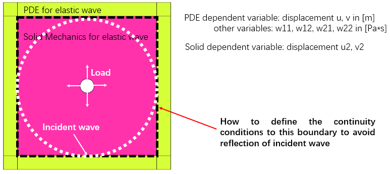

I have two adjacent elastic wave regions respectively solved by self-defined Weak Form PDE and Solid Mechanics (Elastic Wave) Module. The details are shown in the attached image. My question is: How to define the continuity condition on the boundary to avoid reflection of incident wave .
  1. The Solid Mechanics is used for the solution of elastic wave with implicit solver.
  2. The PDE is used for the Perfect Match Layer in time-domain for implicit solver.
  3. Both regions have their own dependent variables of displacement (u,v) and (u2, v2). The PDE has 4 more variables in (Pa * s) coupled with traditional wave equation. The reference can be found here: reference
  4. Insdead of PDE+Solid, I have achieved no reflection with two Solid Mechanics Modules just using displacement contiuity (u=u2, v=v2) but this is not enough in the PDE+Solid version.

The easiest way to set up the continuity is to give the displacement variables in the Solid Mechanics and the PDE interfaces the same name. Otherwise, you can impose two Constraint boundary conditions on the interface boundary in the PDE interface with the expressions "u - u2" and "v - v2". Either way should do the trick.
Hi Ernest, The easiest way to set up the continuity is to give the displacement variables in the Solid Mechanics and the PDE interfaces the same name. Otherwise, you can impose two Constraint boundary conditions on the interface boundary in the PDE interface with the expressions "u - u2" and "v - v2". Either way should do the trick.

Hi Ernest,
Hi, Kiril,
The way you mentioned applies only when PDE (or Solid Module #2) has the same formulation as the Solid Module. However, my PDE is for a self-defined PML, which does not only have displacement as dependent variable but also 4 more stress-related variables (in terms of time integration of stress sx,sxy and sy for 2D). I tried only using u-u2 and v-v2 constraint but it didn't work.

Hi Ernest,
I recommend you to contact COMSOL support team and start a support case with your modle attached. I think it would be easier to figure out how to make the two fields continuous.
Regarding the implementation of a PML for the implicit Solid Mechanics interface, I may assume the demand for such a functionality is not that high. Moreover, as you mentioned, there will be need for auxiliary variables in the PML domains. The number of those will be quite large in the 3D case - for the scalar wave equation for pressure acoustics there have to be 4 auxiliary variables in 3D. This will make the PML formulation computationally heavy. Let alone it will only be valid for a limited number of material models - I can only think of the linear elastic model.
The time-explicit interfaces implement the discontinuous Galerkin (dG) FEM: the PDEs are formulated as the 1st order conservation laws. The coupling between dG interfaces or even discontinuity of the material data in a single dG interface is not straightforward to implement. It is not the question of the solver support, but rather a meticulous mathematical work. The Absorbing Layers present for all dG interfaces are indeed very useful for solving open doman problems, even though the ALs are actually not perfectly matched.
Best regards Kirill
Hi Ernest, I recommend you to contact COMSOL support team and start a support case with your modle attached. I think it would be easier to figure out how to make the two fields continuous. Regarding the implementation of a PML for the implicit Solid Mechanics interface, I may assume the demand for such a functionality is not that high. Moreover, as you mentioned, there will be need for auxiliary variables in the PML domains. The number of those will be quite large in the 3D case - for the scalar wave equation for pressure acoustics there have to be 4 auxiliary variables in 3D. This will make the PML formulation computationally heavy. Let alone it will only be valid for a limited number of material models - I can only think of the linear elastic model. The time-explicit interfaces implement the discontinuous Galerkin (dG) FEM: the PDEs are formulated as the 1st order conservation laws. The coupling between dG interfaces or even discontinuity of the material data in a single dG interface is not straightforward to implement. It is not the question of the solver support, but rather a meticulous mathematical work. The Absorbing Layers present for all dG interfaces are indeed very useful for solving open doman problems, even though the ALs are actually not perfectly matched. Best regards Kirill
