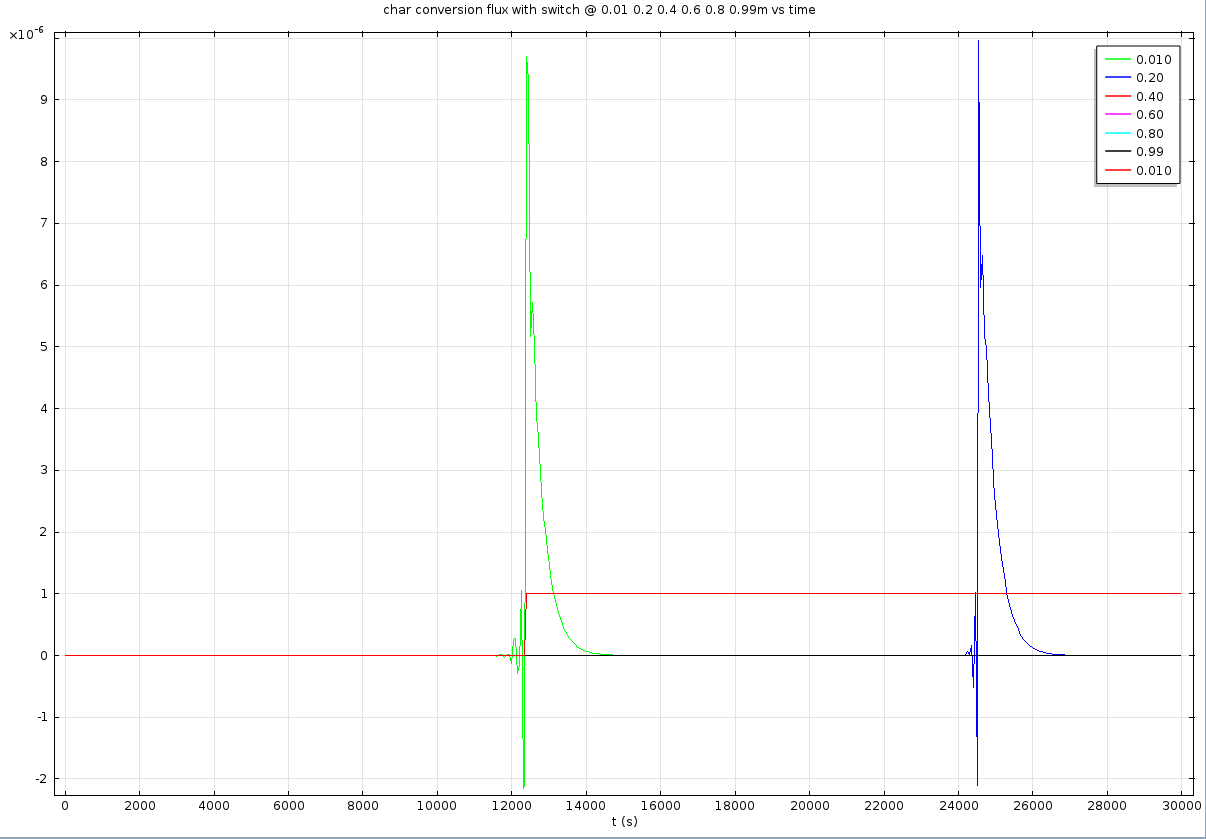

I think the problem is an instability because of the switching on of the PDE. Please view the attached pictures.

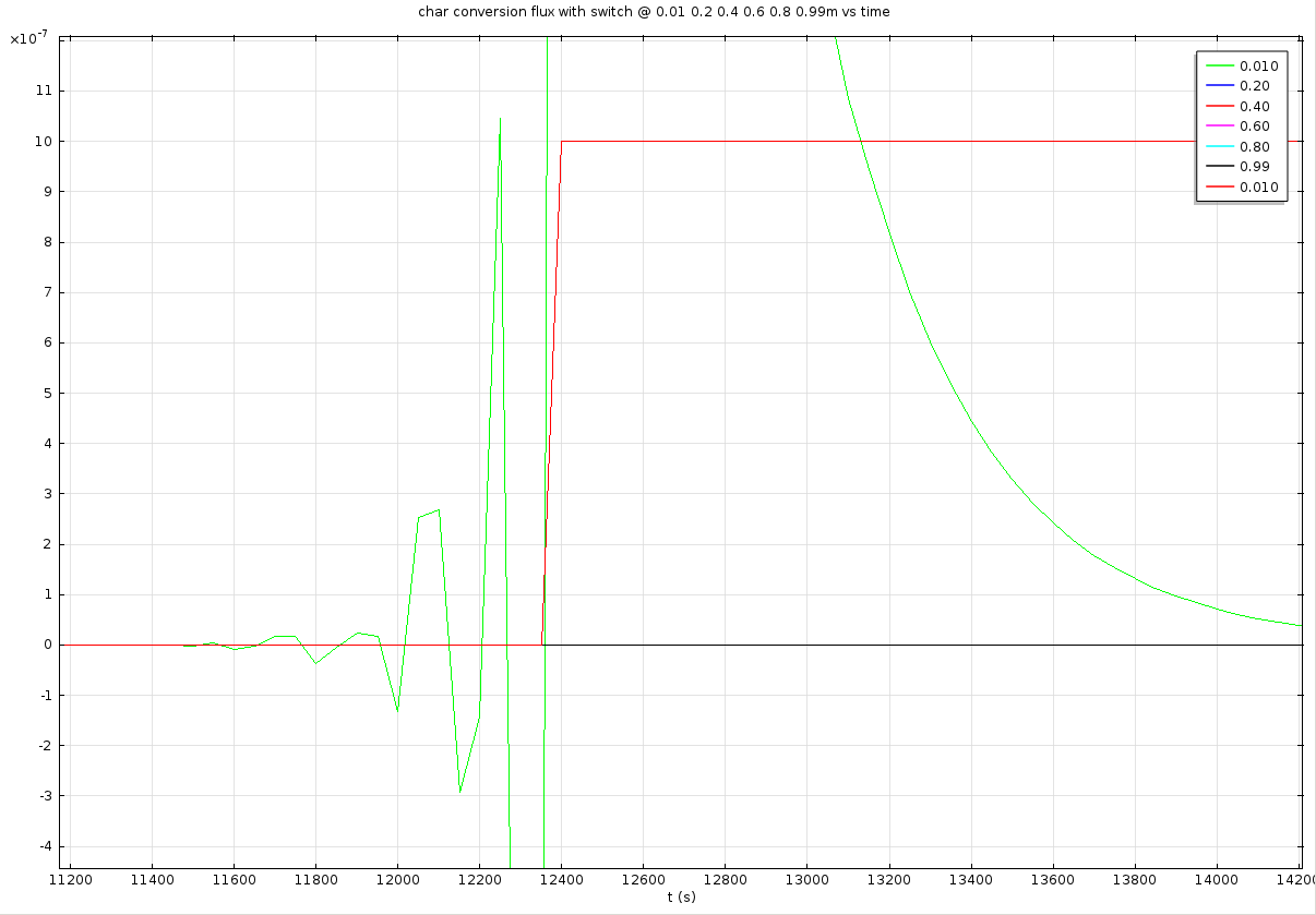

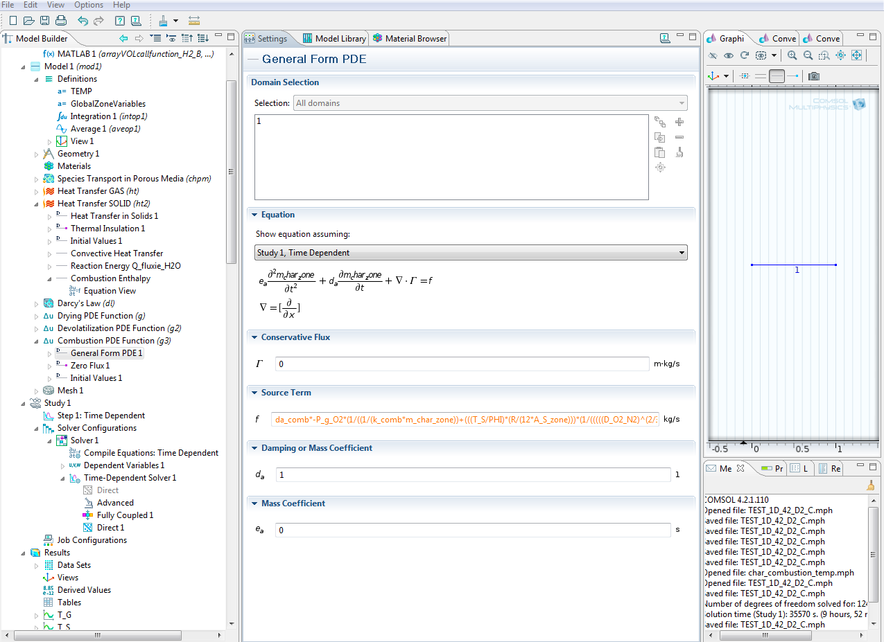

In the pictures you will see the char conversion flux (kg/s) vs time for certain x positions in the reactor. (It is a porous bed of wood particles 1 m long through which hot air flows). The red line is the da_comb switch (scaled). The instability (green) can be clearly seen. I also included an overview picture of the PDE, maybe it is useful.

I find it interesting in the graph that the instability starts BEFORE the switch is turned on. Why is that?

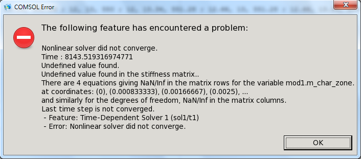

I included 2 more pictures. The first shows the error that I get when include the energy of combustion. I don't know why it says that it has found an undefined value in the stiffness matrix, but it just won't converge.
