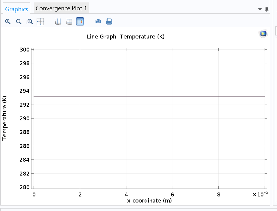

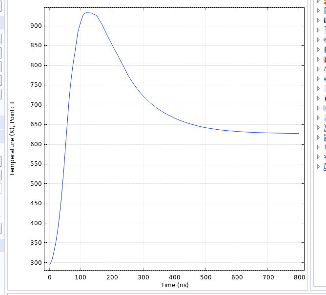

Hi everyone, I am trying to simulate a 1D heat transfer model but my output seems different from I expected. I don't why I got a straight line as my output. Can someone explain the adjustment I need to make? I have attached the images of what I got and what I am expecting. Thank you.

Compare the horizontal axes of your plots. Your first plot is versus space (x). Your second plot is versus time (t). If you need more help than that to figure out the source of your problem, then I suggest you upload your model to the forum.
