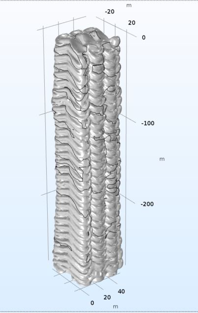

                                                    Hi Jeff,
Thank you for your response. That makes a lot of sense.
However, I run into an issue when I try to create the intersection (I use "Partition Objects" as you've shown in your example). Please see the attached images.
Both object and tool object disapear and nothing is left!
Do you have any advice on that?
Is  it related to the geometry I imported into COMSOL?!
                            Hi Jeff,
