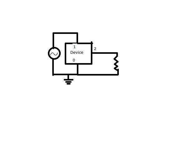

Thanks for the reply. I think I haven't disturbed the Ground node.
I have attached a small prototype of my design, the 'device' is my multiphysics model and i need to interface it with Electrical Circuit connections.
As per the diagram, in my physics model I have declared terminal 0 as ground. Terminal 1 and 2 are of the terminal type 'Circuit'.
In the Electrical Circuit (cir) node, I added a Ground node with node name '0'.
I added an External I-terminal 1 with node name 1 and Electrical potential as term1 (terminal voltage from drop down).
I added an External I-terminal 2 with node name 2 and Electrical potential as term2 (terminal voltage from drop down).
I added a Voltage source between node names 1 and 0 and Source type as AC.
I added a Resistor between node names 2 and 0 with value 100 ohms.
Is there any need to use External I vs U ? What mistake am I doing here ?

Yes you need External IvsU (or UvsI depending on your 'device'). Otherwise comsol can't pass the potential/current of the node between circuit model and multiphysics model

I do not believe this is flagged as an "error" but normally you do not need to define a terminal ground, you can directly set the BC to GND via a GND BC of your physics. Then the defult GND = node 0 of the circuit physics will be connected to your physics GND by default. asically you need only 2 terminals.
Indeed you need either IvsU or the opposite depending on the physics and related deepnet variables choosen, If the Terminal is set to circuit and the IvsU or UvsI show you the drop down list of terminal 1 and terminal 2 then its the correct one. But your IvsU node must also refer to CIRC node 0 for gnd and 1, respectively 2 for the other connection
Check the model library for "CIRC" and train with the examples therein

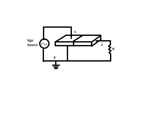

My device is basically a three terminal piezo transformer, where i want to apply an AC voltage to the input terminals for varying frequencies and connect a resistor at the output terminal. The input an output terminals have a common ground. The pictorial representation is as shown in the jpeg file attached.
And my model is as attached. After declaring the circuit connections, I am trying to do a Freq Domain study since I want to vary the input frequency to the transformer.
Any ideas what might have gone wrong? Thanks a lot!

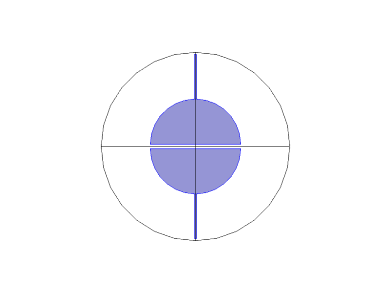

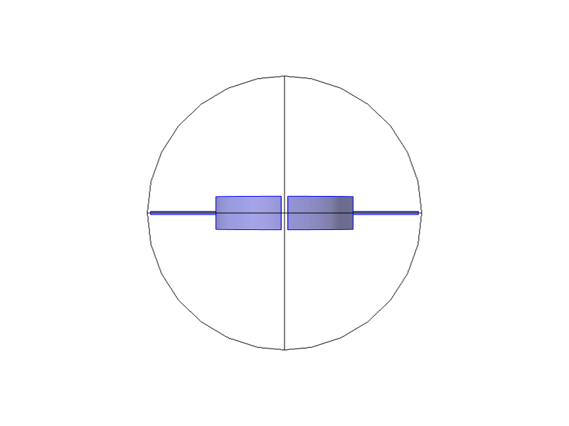

for more complicated circuits such as R C in series what can I do using electric current model with electric circuit model?
Should I add more External I vs Term according to the number of terminals ?
What I try to do is I designed a capacitor from that I want to get the E Fields in Time Dependent -Electric Currents model. If I do simply capacitor with an AC source I can get the E Field map easily, but I want to do it with phase difference between voltage and current. Thus I added my model as a resistor 2 cylindrical stick with appropriate material.
Can I merge EC model with ECIR model in my project?
Note: there is a gap inside the D shapes.

other ideal sources. This results in the error message The DAE is
structurally inconsistent. A workaround is to provide a suitable parallel
or series resistor, which can be tuned to minimize its influence on the
results."
from page 76 of this manual hpc.mtech.edu/comsol/pdf/ACDC_Module/ACDCModuleUsersGuide.pdf
Regards!
This information Could Help "The “External” features are considered “ideal” current or voltage sources by the Electrical Circuit interface. Hence, you cannot connect them directly in parallel (voltage sources) or in series (current sources) with other ideal sources. This results in the error message The DAE is structurally inconsistent. A workaround is to provide a suitable parallel or series resistor, which can be tuned to minimize its influence on the results." from page 76 of this manual http://hpc.mtech.edu/comsol/pdf/ACDC_Module/ACDCModuleUsersGuide.pdf Regards!
