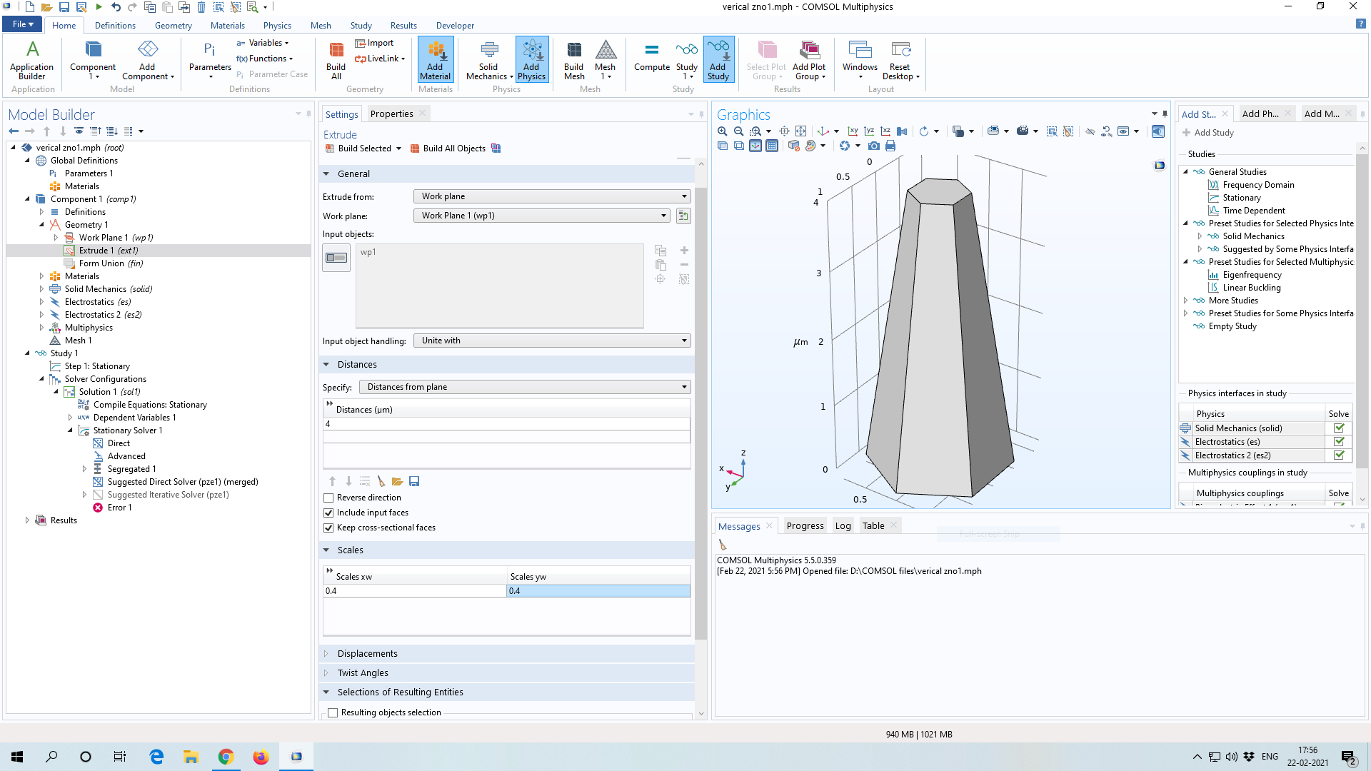

Hi Mr. Jeff Hiller, Could you please assist me in building the vertical hexagonal shape? Here I want to built a geametry of hexogonal rod, but I'm unable to set the vertices of top and bottom is to be 0.4micron. I'm unable to build the bottom one as the same.
>Hello Rehan, > >In the following [thread](https://www.comsol.com/forum/thread/249171/comsol-multiphysics-intensive-online-training?last=2020-02-14T13:31:41Z) I listed the main free online training resources available to you as you get your feet wet with the software. > >Best regards, > >Jeff > Hi Mr. Jeff Hiller, Could you please assist me in building the vertical hexagonal shape? Here I want to built a geametry of hexogonal rod, but I'm unable to set the vertices of top and bottom is to be 0.4micron. I'm unable to build the bottom one as the same.

I don't understand. The screenshot you attached seems to show that you have succeeded in drawing the hexagonal shape you want. Can you please clarify in which way it is not satisfactory and attach your mph file?
Hi Rehan, I don't understand. The screenshot you attached seems to show that you have succeeded in drawing the hexagonal shape you want. Can you please clarify in which way it is not satisfactory and attach your mph file? Best, Jeff

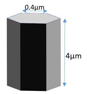

OK, Actually I want to build only a 3D heaxagonal of edges 4um and 0.4um. Here I attached a file like this. Mr. Jeff Hiller, can we discuss via video meeting mode if need? Best Rehan
>Hi Rehan, > >I don't understand. The screenshot you attached seems to show that you have succeeded in drawing the hexagonal shape you want. Can you please clarify in which way it is not satisfactory and attach your mph file? > >Best, > >Jeff OK, Actually I want to build only a 3D heaxagonal of edges 4um and 0.4um. Here I attached a file like this. Mr. Jeff Hiller, can we discuss via video meeting mode if need? Best Rehan

Sorry, I cannot offer to video conference. A straight hexagonal rod can be drawn by following the same steps that you used to create the conical one, except that you don't specify the 0.4 factors for xw scales and yw scales as shown in your original screenshot (That's what's causing it do be a cone) and that you'd provide the desired lengths for the base hexagon and extrusion distance.
Sorry, I cannot offer to video conference. A straight hexagonal rod can be drawn by following the same steps that you used to create the conical one, except that you don't specify the 0.4 factors for xw scales and yw scales as shown in your original screenshot (That's what's causing it do be a cone) and that you'd provide the desired lengths for the base hexagon and extrusion distance. Best, Jeff
