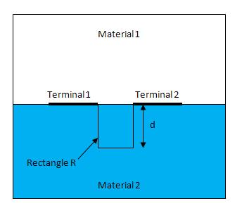

I am trying to simulate capacitance between two electrodes with the electrostatics module of Comsol 4.2a using a model succinctly described in the attached picture.
I want later to investigate the influence of a "trench" (rectangle R in the picture) in material 2, i.e. the rectangle R will have the properties of material 1.
Before doing this, I checked what happen when I insert the rectangle R in the model but still apply the properties of material 2 to it. And here comes the unphysical results: the predicted capacitance value vary (quite importantly) with the height d of the rectangle R. This does not make sense from a physical point of view . I understand that the mesh is modified each time that the value of d is changed and that this discrepancy may be related to that. But this is very annoying to me as I feel that I will not be able to make the difference between numerical artifacts and real capacitance variation when I will investigate the influence of trenches in material 2.

Thanks for your answer Amine.
I found the problem: what made the mess was just the "infinite" elements that I used in my model. If I replace them by large surface without the "infinite" property, I do not observe the problem mentioned before.
